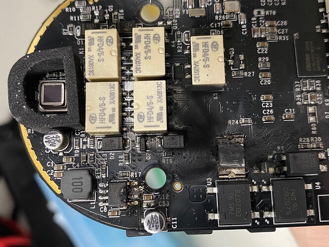

Anyone have an issue with the thermostat burning up? Mine ran for about a month.

sorry for the experience. It is the fuse getting overheated. Our internal fuse was set to take <29V (should be 24V) so if anything goes wrong, it will break to protect the rest of your system, which is more expensive. It may be caused by a power surge. Could you please contact our customer support to get a replacement? Meanwhile, we will update our fuse to take more voltage for the systems with unstable voltage.
I have never measured more than 24v on the secondary side of the transformer. This blew the 3amp fuse that is in place. I can tell if the power in the house went out for any reason and it didn’t so I do not suspect a surge. I have gone through the support pages and am attempting to get this resolved. It will be cold here tonight (by Texas standards) and I currently have no heat control. Definitely need this resolved quickly.

Cheap “24 V” furnace transformers often output up to 32 volts when unloaded.
If this is common knowledge then the thermostat would be rated for it. I could install a regulated power supply but I am not going to do that.
Yeah, looks like this 8 pin chip shorted out and then took the fuse with it.
I’m assuming that this is the fuse image
