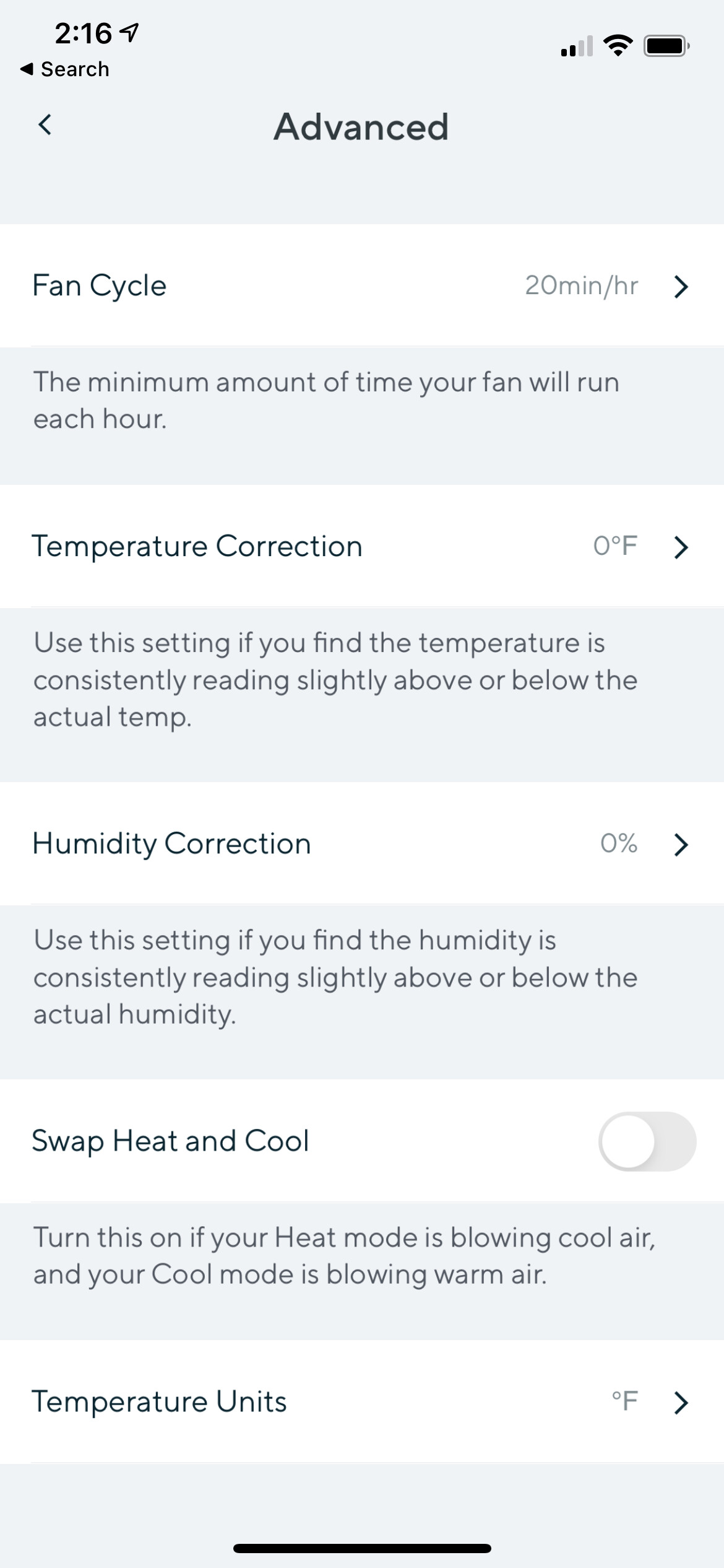

Same here Joe but I do see the swap heat and cool. Is your wyze app up to date

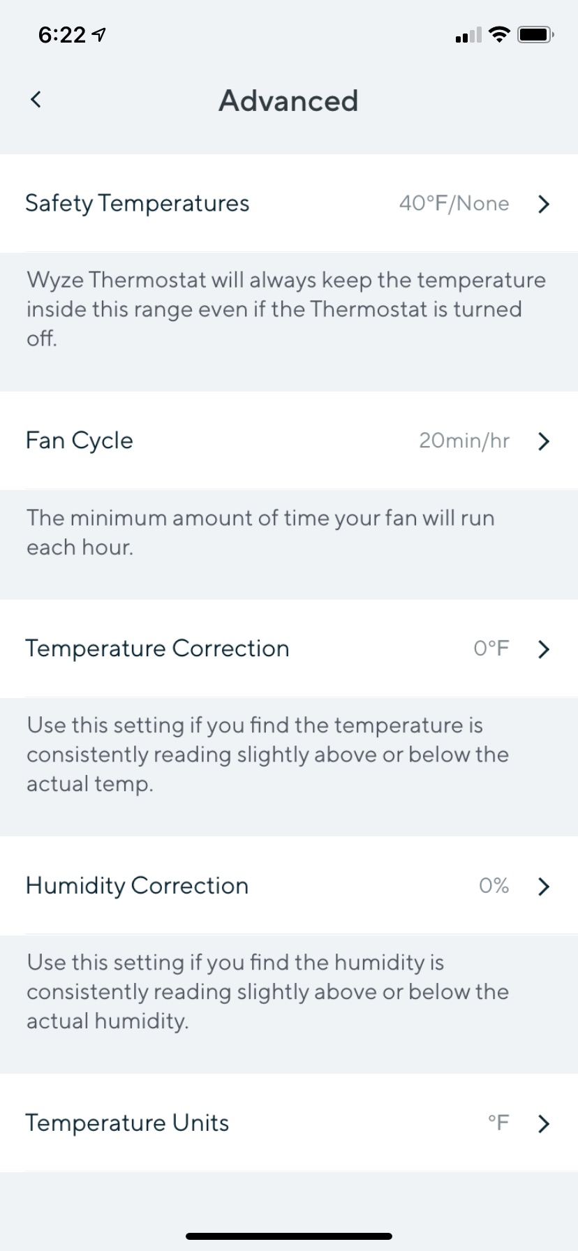

Tap on “Controls” at the bottom of your Wyze app when viewing your temps, then take a screenshot and upload it here.
That looks like the Controls and Settings for a Furnace, not Heat Pump.

I installed mine and app turned on the swap heat and cool. I had to go in and turn it off to get it to work right.

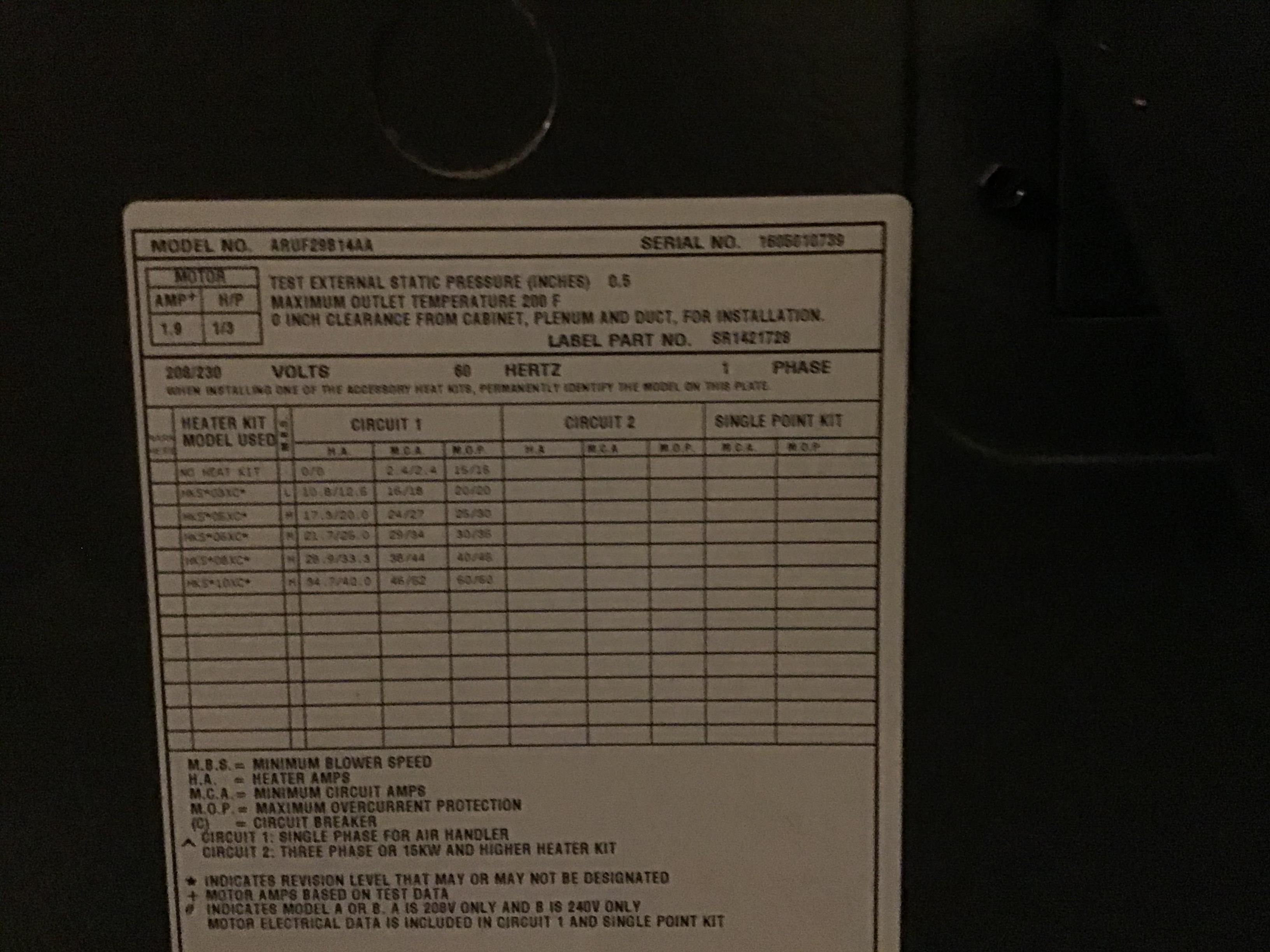

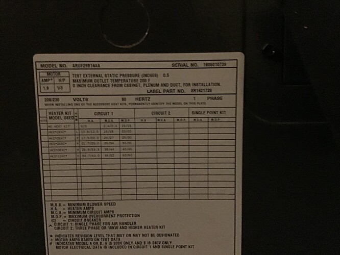

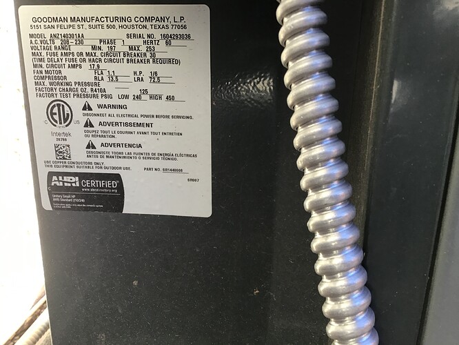

Everest elite series. Has unit outside and air handler inside

@joebruhn Can you provide me with the model numbers?
See attached.
