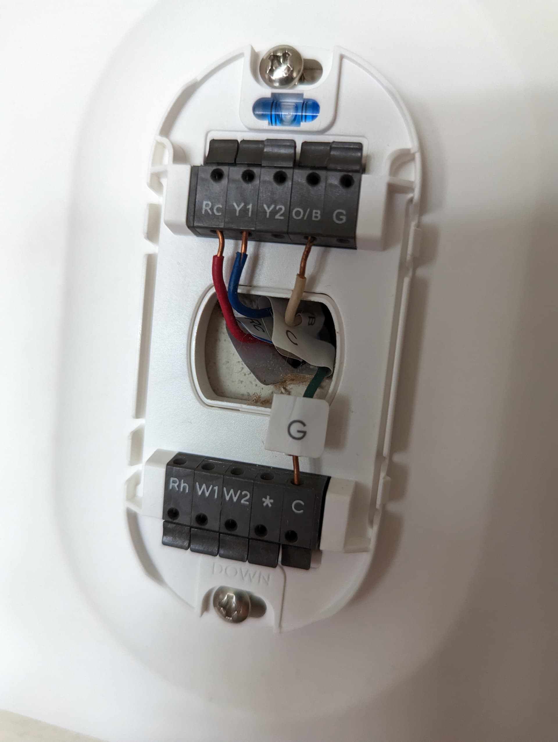

The wiring under my thermostat is as follows;
RC, Y1, O/B, C

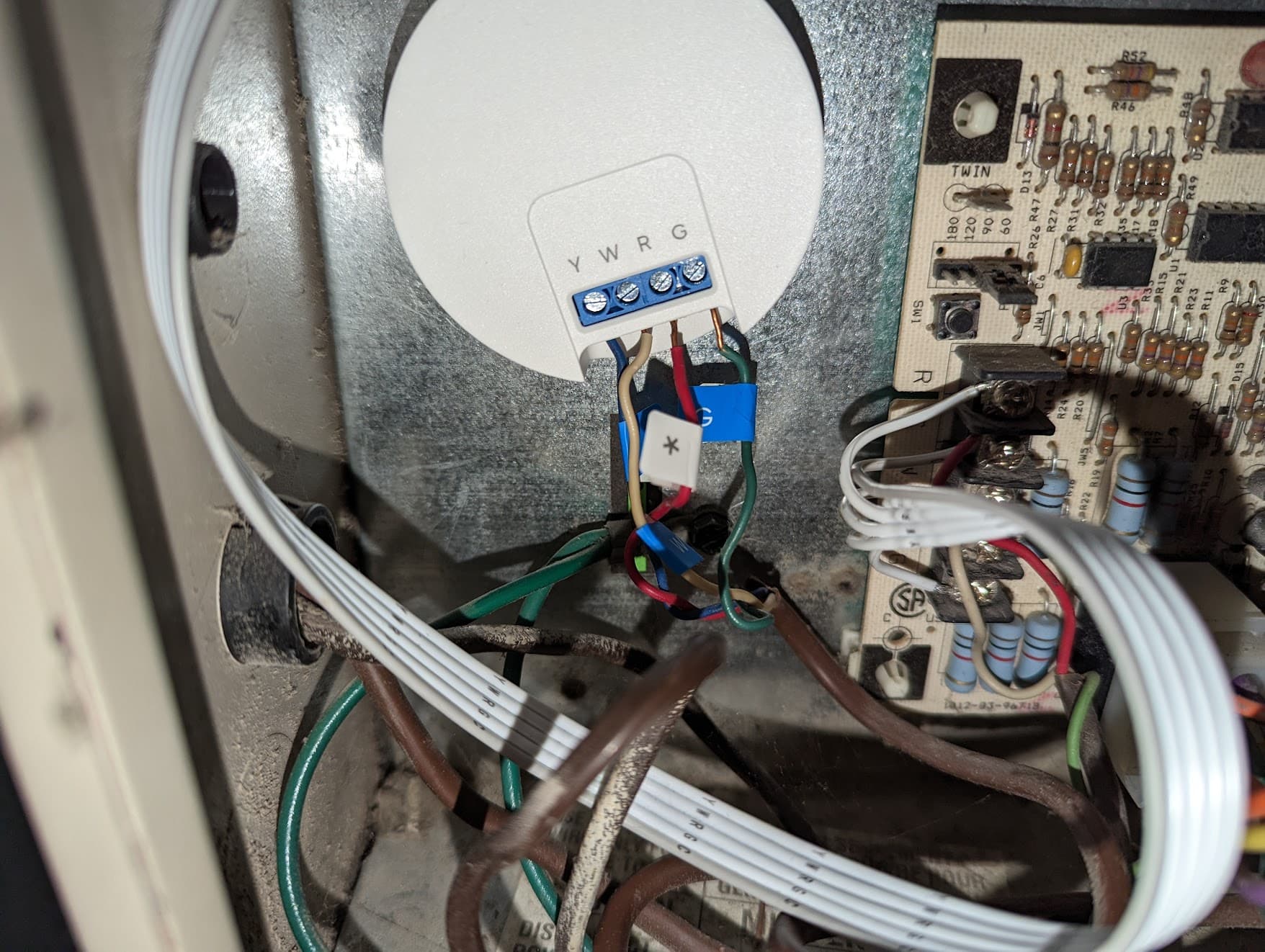

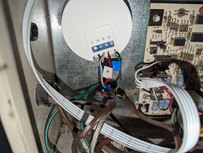

I am sorry this is happening. If you can post some photos of your wiring it will be easier to help. Possibly a photo of the wires going into the thermostat and the wires at the control board.

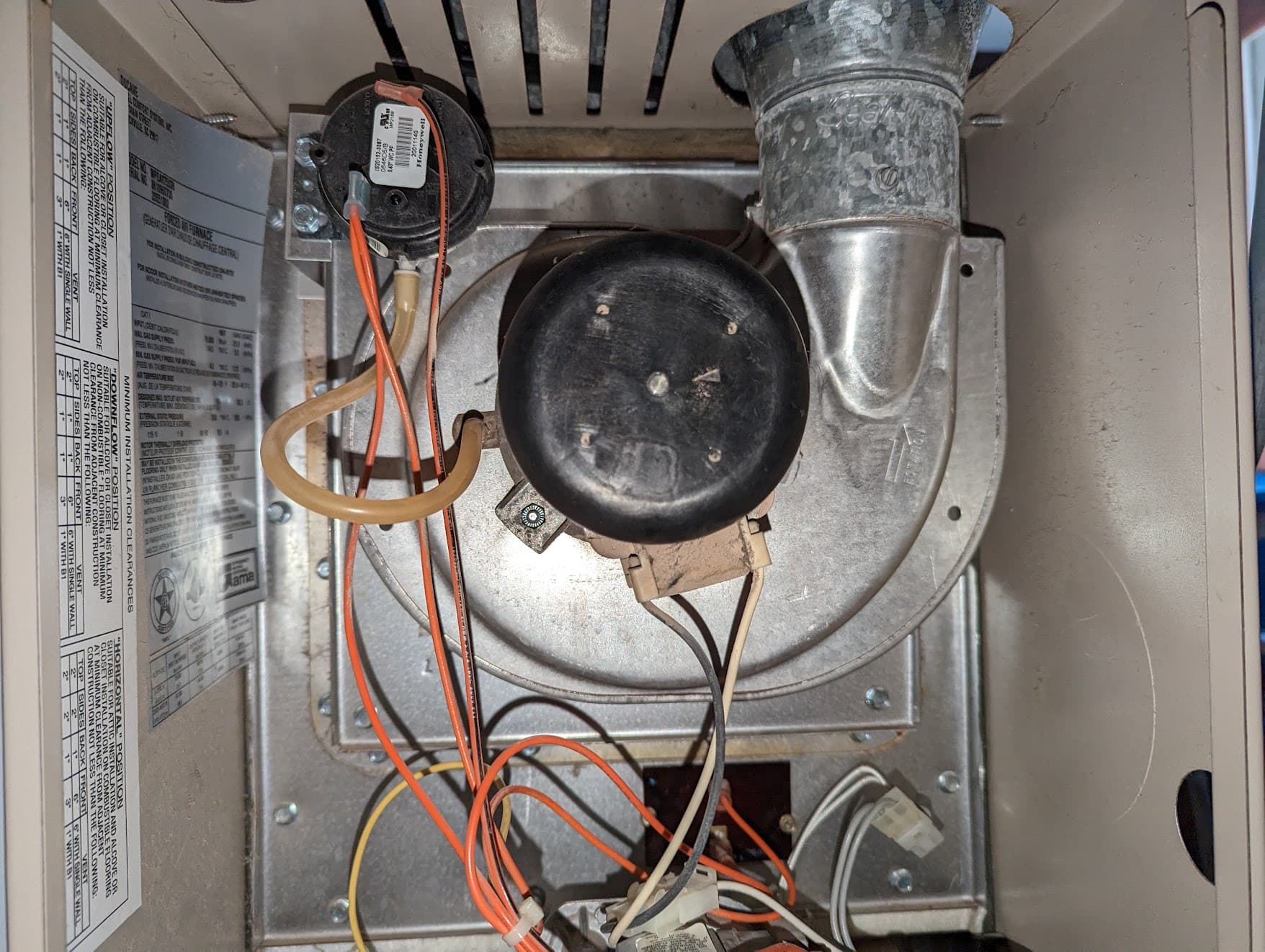

What brand of heatpump do you have? model number, etc.
I’ll do my best to get you this info, I don’t know much about this though so any info when I’m looking would be helpful.
I’ll try to look tonight and see what I can find.
My apologies for the delay,
I have finally procured pictures. I attempted to attach them to the post however it says I can only attach 1 image at a time, therefore I have attached a google photos link with pictures.
Please let me know if you would like pictures provided on a different platform.

This is a gas furnace, not a heatpump,
You have the following wires:
Rc: Red
W1: White
G: Green
Y: Blue
Reset your thermostat and tell it you have those wires. You’ll need to move the white wire that is in O/B on the wyze to W1. It will walk you through the setup of the C adapter, but it;s already hooked up, so you can ignore that. After you complete the setup, the furnace shouldn’t stay running constantly.
I did as you said and it is working perfectly! Thanks so much!
