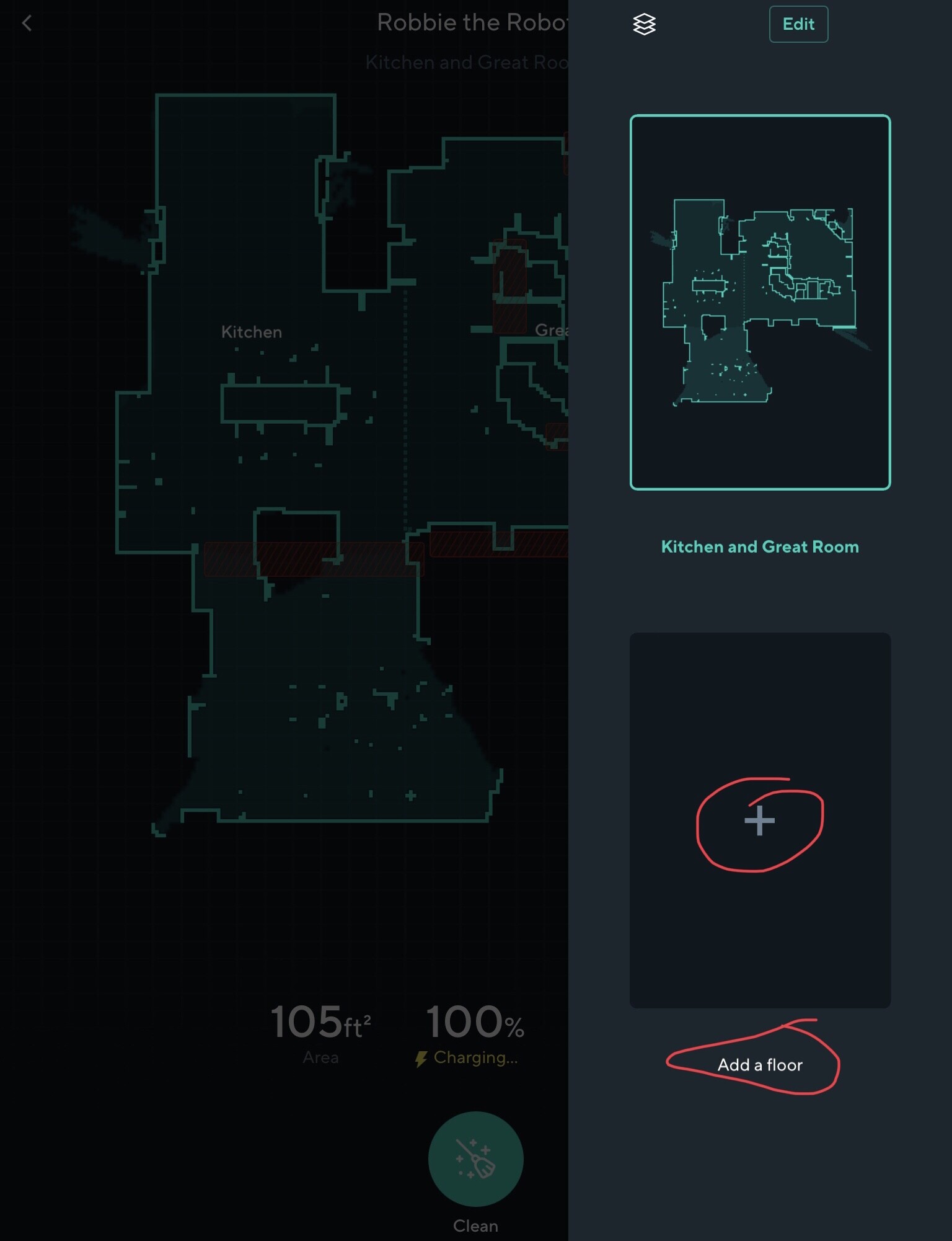

How do you set up a separate map of the area? There is just one map, like in the diagram above.
You can add additional maps for the same areas:
You don’t even need to do that for what I was referring to. Just use the no-go zones to create virtual hallways just wide enough for your vacuum to march through one room into the desired room you want to clean. I do that for a bedroom in the back of my house two rooms away from the dock and it works fine.
The only icon I have on my map screen is the pencil to edit the existing map. There are no other two icons which are displayed above it in the above pictures, and no option to add another map.

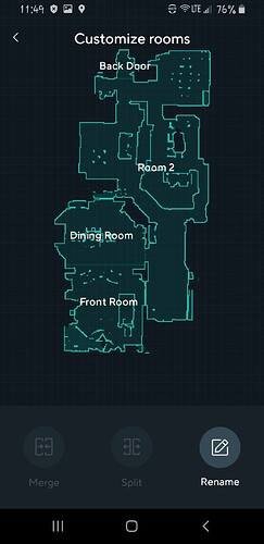

I have the same issue. I cannot divide my kitchen, breakfast area, foyer, or my family room using interior walls. My front room, and dining room divided just fine. I’ve remapped 5 times already. Am I doing something wrong?

  3. Add a better way to define rooms in the map. Something similar to the process that creates no-go zones (adjustable rectangle) would be nice to specify rooms. The current process works well on “standard” rooms with hard walls, but there are exceptions. Our dining room is open on two sides. The current room process won’t let me accurately map the room because it doesn’t have hard walls to attach the “split line” to. The best I can do is attach a line from the far wall of the dining room to a wall in the hallway. Not ideal, especially if wish list number one is ever added.
