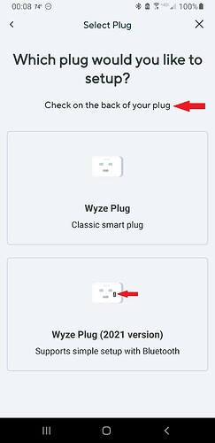

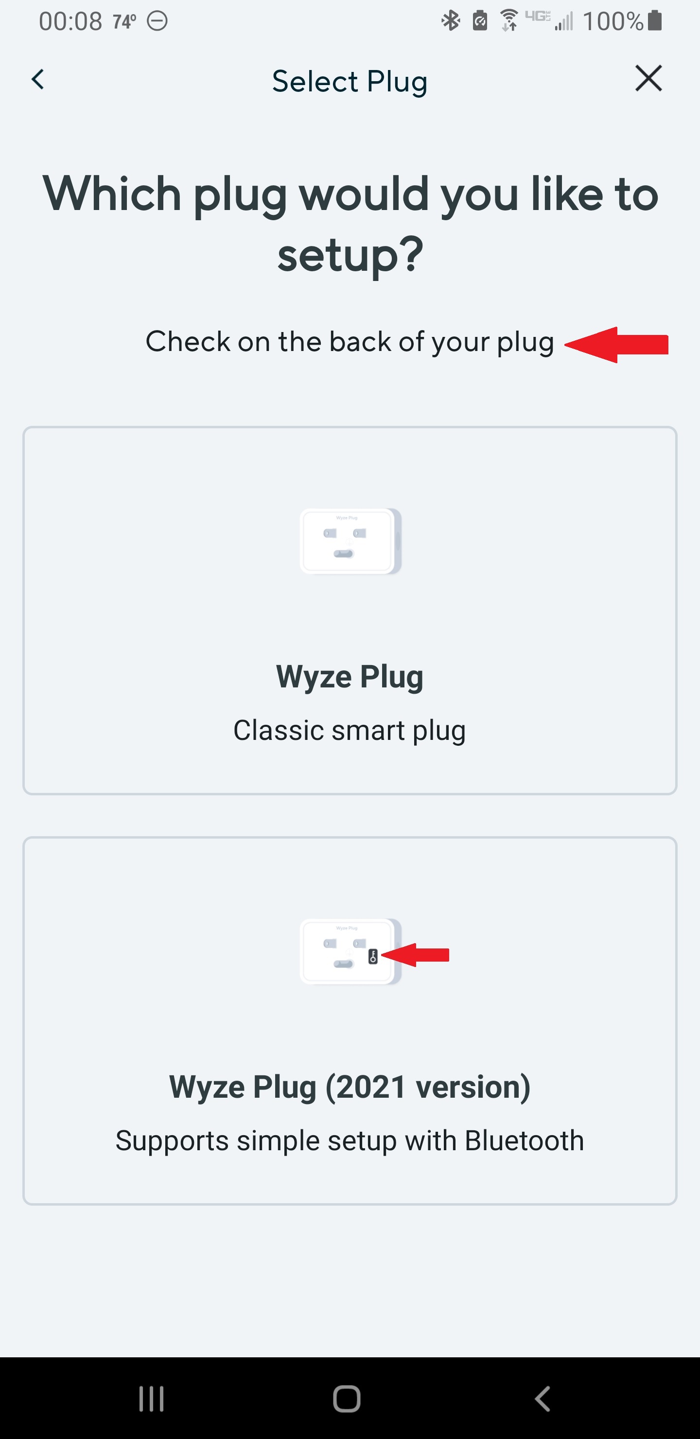

Thank you. I was about to send mine back for refund. This worked perfectly.

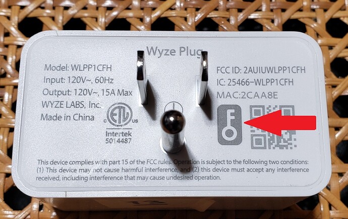

picture of a key in the BACK!!! omg, was i the only person that thought ‘there’s no key [on the front] so i must have the older version, bummer…’ ??

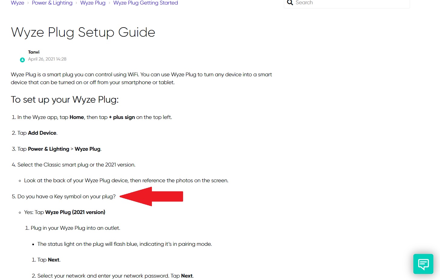

thank you for calling and thank you again for posting. didn’t even need steps 2 and 3. worked like a charm after just step 1.
2021 version! how would i have figured this out?
Thank you SO much for telling us about that ‘key’ symbol. Now mine connects!! ![]()
I’m on Samsung android and had same issue with not seeing Wyze_smartplug_apxxx network. I just updated the Wyze app and it worked
I have the 2021 edition Plugs with the key symbol on the back. Location should not be necessary during setup and requiring that is a real privacy weakness. Why can I not simply connect my iPhone to the Plug via Bluetooth in order to configure the Plug to my WiFi network?
This works great! I was so, so frustrated. Why wyze support did not say that instead of repeating the website messages
Thank you! Wyze needs to change their instructions for the new plugs and change their box package to indicate new bluetooth plug!
