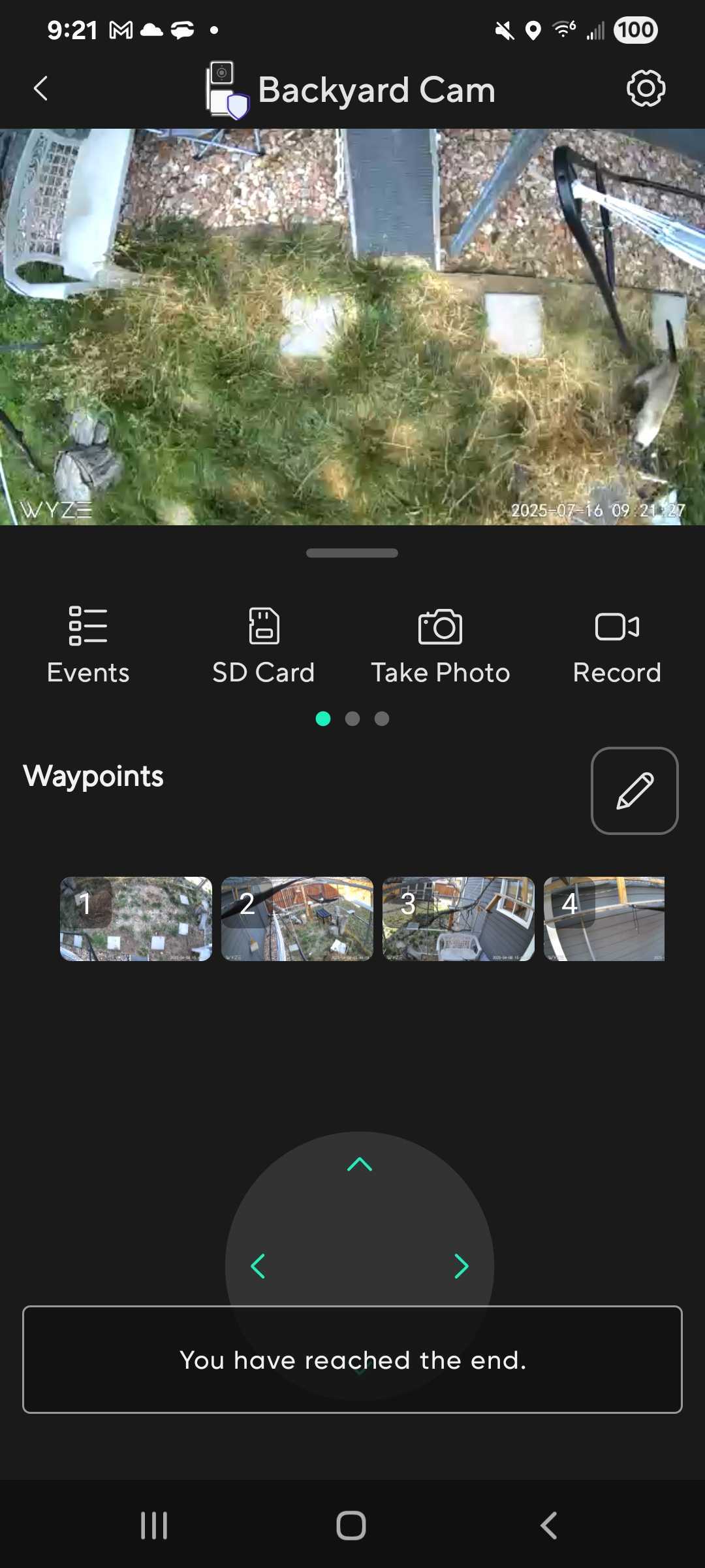

This is my second Pan Cam that has completely lost the ability to pan. I have a pan cam in my cat run, and I like to check on my cat throughout the day. I use the pan arrows to turn the camera and see what my cat is up to wherever she is in the cat run. The first Pan cam worked for a year and then, no matter which pan arrow i press, it says ‘You have reached the end.’ It is only able to pan up and down about 90 degrees, if I hit the left or right arrow it might twitch slightly in that direction and then say 'you have reached the end. When I press the way point buttons nothing happens. Here is the troubleshooting that I have already tried:

It’s mounted with the camera pointing down, hanging from the roof of the cat run. I don’t believe its a motor failure as both cameras are still able to move up and down about half of the field of motion they used to have, but they can’t go side to side (left to right) more than like.. a very small amount. It seems like they’ve just lost most of their range of motion and I wonder if it’s software related since it’s displaying on screen ‘you have reached the end’
I took a screen recording but it wouldn’t let me attach it directly, here is a link to the video Imgur: The magic of the Internet

“you have reached the end” just means the cam has detected that it is unable to move any further. While I wouldn’t normally recommend this, you can power the cam off and physically rotate it side to side (and up and down if that has issues too) a couple of times. If it is seized and won’t move try wiggling side to side and see if it comes free.. Might be a grain of sand or something stuck in the gears.
