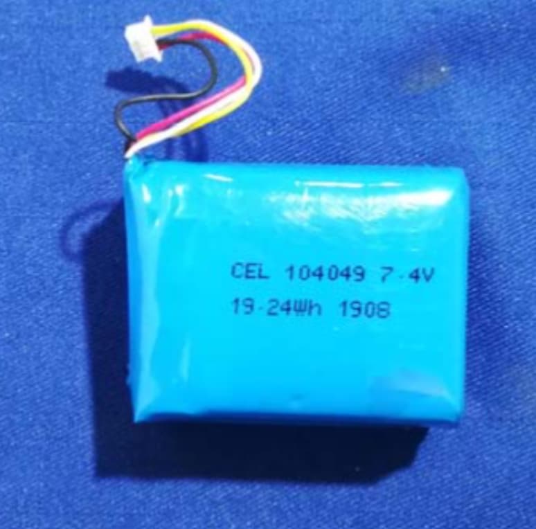

What kind of batteries does Wyze use?

These:
I’ve only looked on Amazon (Canada) and the best I can do is around $36. At 1/3 the price, It’s just as well to buy a v2 outdoor camera.
