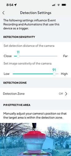

I’ve got detection settings at 11 for distance and 91 for image sensitivity (and I have CamPlus activated for it). So - the cam has caught myself walking in the background before - but no hummingbirds yet. I’m not even sure I’ll get a hit until spring - but I don’t want to miss any winter stopovers just in case. Do I have the settings right for this setup?

Awesome idea sneaking up behind it and testing with your fingers like that. Granted it may have picked up heat from your hand & wrist too, but it was a great test to see if something the size of fingers was sufficient pixelation for the image sensitivity settings too.
You set it up pretty smart: fairly close, so they should appear large to the camera by taking up more pixels.
It is hard to tell you exactly what sensitivity settings are best since it varies a lot in each situation. On the one hand these are tiny animals that will have a very small heat signature so it may require increased sensitivity for the PIR to trigger. I think your PIR zone is excellently placed though.
I truthfully think you have a decent setting and positioning. I would test that and then possibly adjust from there. You may need to increase the pir "distance"setting to see if that helps make it more sensitive to the tiny birds if you find it’s not triggering sometimes. On the other hand we’d want it to ignore the wasps and not catch people in the background as much, so we’ll have to see how it does first.
Another thing to consider if you find it catching you in the background too often is to possibly angle it in a way to not catch people in the backyard, ie: Angle it upward more, or flip it upside down so the sensed area is up top instead of on the bottom.
Again I think your settings look like a good starting place for your intended use case. After some time adjust them up and down a little until you find the exact one you like the best. Maybe this is already perfect. From your tests and position, it might be perfect.

Makes sense to let it capture people in the backyard then. Could be okay to turn up the sensitivity a little bit then, but maybe not too much to reduce trees and such triggering false alerts.

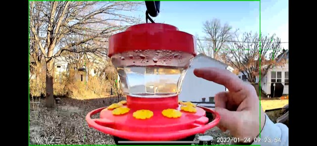

The flowers on the feeder appear to be out of focus, so I’m guessing your subjects will be also. My V3 is about 4" from my platform feeder (see my post). The farthest edge of the feeder is about 17". With the stock lens setup, the only things in focus were from 12" and further.
I disassembled the unit and refocused the lens. Now everything from 4" to 17"+ is in focus. Infinity is slightly blurred, but who cares.
It takes about an hour to refocus the lens. Lots of YouTube vids to show how to disassemble. The camera is still waterproof–been in several duck-drownders since. Or, just move the camera back until the closest side of the feeder is in focus. (That seems to be about 12-14" on the V3)
I have the Outdoor cam - so it’s different than the V3 - I’m not sure if it’s the same focus length. I can try to back it up a bit more, but I don’t want it to be too far out of frame. At the same time, I’m definitely not doing anything to void the warranty right now. LOL.
fingers
This is sort of a test shot I did earlier, how my fingers appear at hummingbird level. So it’s not terribly out of focus, as you can see. At least not to my eyes. But at the same time, this is the “HD” view, I think, from the motion capture I got. It’s fine for me, I think.
Well, the picture does seem a bit blurry, so it could be a little too close to the camera.
My camera is about 12 inches away. Which I think was a good compromise distance. A hummer triggers the motion detection. I want to see who’s coming and don’t need that much detail.

Yes, if you are mostly just watching who comes and goes, your focus is a good compromise. I only changed mine because I wanted well focused photos (and I like to “fix” things that aren’t broken LOL).
