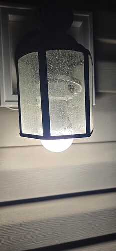

My fix to this was to purchase Nyce Power Lampchargers and Wyze outdoor rated bulbs.
Now I know that this extends the bulb outside of the lamp housing, But this is the only thing I could come up with.
Now it would be nice if Wyze had a 120VAC powered remote switch to control the light bulb, so I don’t need my phone all the time.
