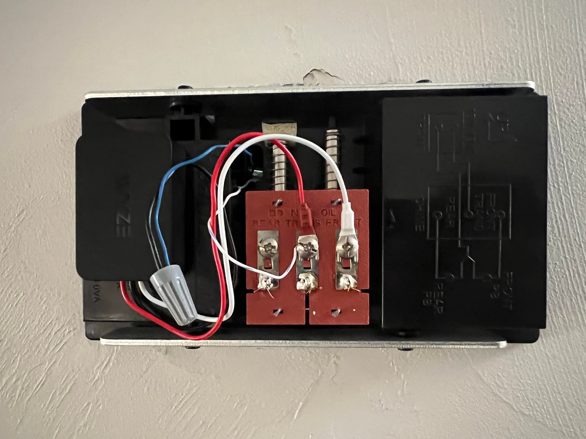

Thanks for posting that information. I have an electronics background, but am ignorant of doorbell transformers. I found 10VA stamped on mine, and measured the voltage at 19.2 V.
If your new transformer resolves the issue, please post a link to the product.
Also, as shown in the attached photo, my existing transformer is installed high on the wall in the garage, attached to a metal cover plate. Do you (or anyone else) know if the transformer is plugged into a socket on that plate (that would be too easy), or do you have to take the plate off and re-hard wire a replacement transformer?
