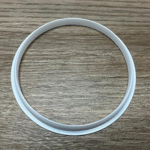

By any chance has anyone found (and maybe has a link) to an o ring that fits proper in the cordless vacuum?
Replacements are out of stock indefinitely and the vacuum is useless without it since it leaves an open gap in the chamber. My replacement order has been in purgatory over a month.

A colleague of mine lost his O-Ring. He ended up ordering this:
says it worked perfectly for him.
Thanks @spamoni , I’ll give it a try
I’m in the same boat with my replacement o-ring order not being shipped.
Thank you @spamoni for the etsy recommendation, I’ll give it a try as well.
I ordered a couple. I had a question, and the seller/maker responded in minutes and shipped them the next morning. I received them 2 days later. They work perfectly, I highly recommend, And very reasonably priced. Thanks for the tip!

I just ordered a gasket. Previously, I made an inquiry to this Etsy seller if he could make a bracket for the version 2 Sense. He designed it that day and I had the brackets in an incredibly fast amount o f time. It’s just a coincidence that I discovered this post,
It is a shame that we must pay a third party for this, but I am very happy to support this small entrepreneur.

I found another source for a replacement gasket as there was no Amazon stock on hand. I ordered part 1302N271 (Buna-N O-ring 70A 112mm OD, 104mm ID, 4mm) from McMaster-Carr for $5.94 for two gaskets plus $7.67 for UPS shipping. They arrived less than two days after I placed my order.
The replacement gasket fit is the same as the original (hence, the loss hazard still exists) and the vacuum is back to working as it should. I am going to try placing a few tiny bits of “Sticky Tack” modeling putty underneath the gasket in the hopes that it will keep it from falling out when emptying the canister, yet easily removed if it has been replaced.

I glued the O-Ring to the hinged cover to prevent it from falling off.
