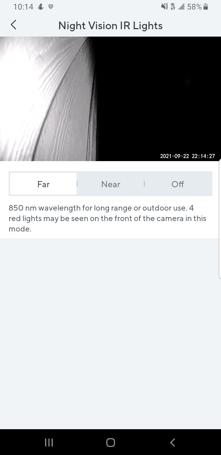

I would like the community input on addressing the glare that is reflecting off the wall when I enabled the infrared lights to get a better night vision. Tried the settings but no success. As you can see from my screen shot this view is not the typical angle for the wall mount.
There may not be a good solution to this or you may have tried this. However, given the viewing angle, you could try moving the camera to the tight some. Obviously it will depend on the area you would like to see or capture and the area you are trying to avoid.

Thanks all for the feedback.
I ended up turning off the infrared light but left the night vision on. See the attached screenshot. I am guessing if it weren’t for the glare, I would have a better quality video with the infrared on. Although this cam version is built in to operate in the outdoor environment out of the box, I’m thinking maybe if I were to purchase the right third party housing with a good articulating
mount, it may address my issue.
You might also try masking off the illuminating LEDs on the left side of the camera, or using a separate IR illuminator that is pointed appropriately.

Hello cjhawail.
Maybe a solution to your issue with the IR reflection off the wall would be to rotate your camera’s aim to the right as has been suggested earlier. Test the rotation live with the Wyze app by having someone stand where you want your camera to see them while you manipulate the camera’s aim. Hopefully most of the reflecting wall will be off view?
Victor.
Having less wall in the frame might cause the camera to adjust the exposure enough that your area of interest is exposed properly.
