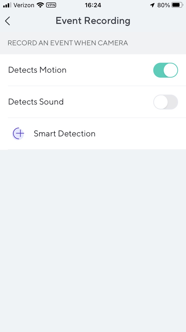

No. They are turned on. I have had three Wyze cameras and the first two notifications worked fine until a firmware update. The cameras bricked with the infamous yellow light so I returned the cameras. I then bought a third camera and this one is working fine except no notifications are pushed through. I do not want to update the firmware in fear of the yellow light of death.

Mine just stopped sending motion alerts. Did all the trouble shooting steps and even factory resest and the whole 9. Nothing works. This is so frustrating when things just randomly stop working and you have zero ways to fix it
Are events logged but you don’t get a notification?
If so, and you’re using android -
In the wyze app settings, enable “running in background”. Then in android settings for the wyze app go to battery and change to “unrestricted”.
That seems to have fixed the missing notification issues for a couple of us, and I haven’t seen any issues with increased battery usage.
If it isn’t logging events at all, there are different troubleshooting steps for that.
