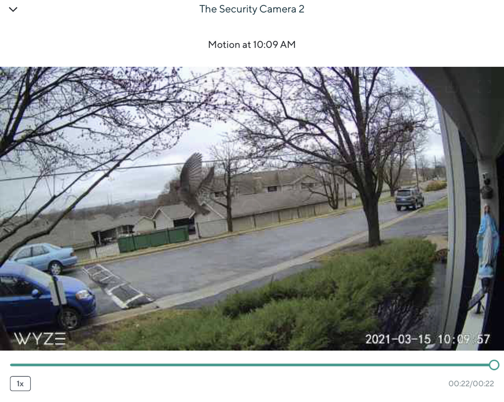

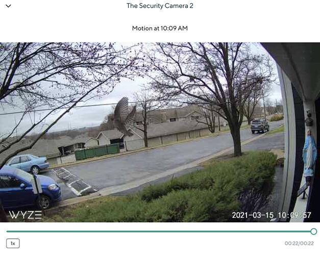

My CamPlus is identifying birds as VEHICLES,… constantly!
@kansascitygreek
It is not identifying the bird as a vehicle, but the multiple vehicles that are in that video
But, the two blue vehicles belong to me and the neighbor’s car are parked and have been parked for ages and this just started happening today. It’s doing this every time a bird goes into the camera area. I’m getting a ton of notifications today and those are all a vehicle notification. And even if you were correct, it should not be identifying parked vehicles as motion detected.

You’re not quite getting how it works. The camera picks up motion. It sends a clip up. The Wyze server looks at the footage and determines if there are people/pets/cars in view. The server does NOT (so far as I know) attribute the original motion triggering to any of those particular objects.
I get it completely. My Ring Camera and Nest Cameras give instant notification and THEN send it to the Cloud for identification. Wyze sends it to the Cloud FIRST and THEN sends a motion detected notification. I’d rather skip identification totally if it would give me an instant motion detection notification. It does matter if it’s a person, vehicle, or pet if they are long gone when I get a notification… or if I don’t get one at all… (and that happens as well). This upload delay or failure to notify of motion will be the death of their monitoring service.

No. I am trying to explain to you why it tagged the video as ‘vehicle’ even though it wasn’t motion of the vehicle that triggered the event recording. Think about it.
I realize that… and thank you for trying to help. But the mis-detection for birds as vehicles only started this morning. I have not moved the cars in ages. For some reason, several months ago the detection did exactly what you said as my parked cars were parked and yet, set off vehicle detection repeatedly even without surrounding motion triggering detection. This happened just randomly. Then, that stopped for some reason, thank God. The birds are obviously triggering the detection of movement and being identified as vehicles. The birds have been around all winter as I have a bird feeder and they never triggered the camera’s motion detection…until this morning.
