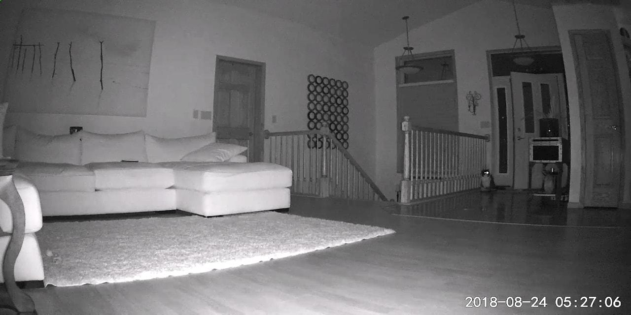

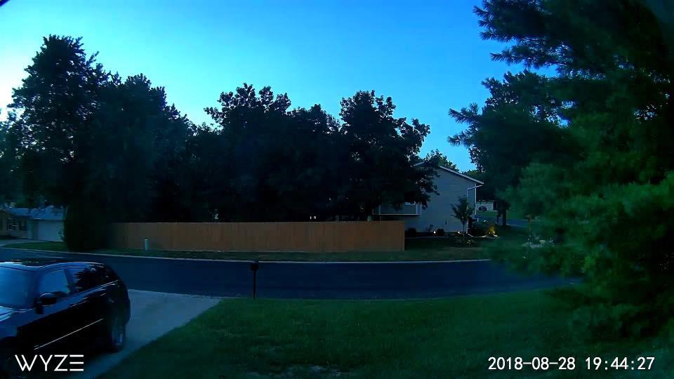

  2. The dark current for the JX-F23 sensor is 4mV/sec, a 75% decrease from the 12 mV/sec dark current of the JX-F22 sensor. Dark current is one of the main sources of noise in image sensors, as a result the JX-F23 sensor has better low-light performance compared to the JX-F22 sensor. Below are two sets of comparison images from Wyze Community testers.
Set 1, JX-F22:
Set 1, JX-F23:
Set 2, JX-F22:
Set 2, JX-F23:
