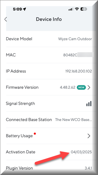

I received my shiny new Wyze Cam Outdoor v2 Starter Bundle today (gots to love Amazon’s next day Prime Delivery).
I set up the Base Station, refusing any firmware updates, it shows out of box to be running 4.16.3.117 (my existing updated Base Stations set at: 4.16.4.523)
I then installed the shiny new WCO v2, refusing the firmware update.
It’s firmware is: 4.48.2.62, (my existing WCO v2 sets at: 4.48.4.427)
I’ve set Recording Cooldown to “No Cooldown”, and beings it can take a day to covertly swap itself to 1 minute, I’ll monitor from here, and post the outcome of my test.

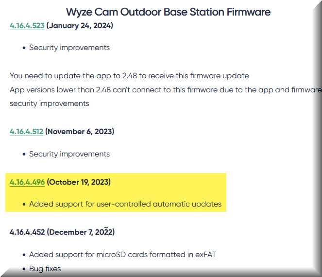

Good Morning @Antonius , thanks for the advice, you had me ‘scrambling’ to look for that seeing this morning on both devices.
I was relieved to see the option was not available, and then went to the firmware release notes to see that feature was added on Firmware 4.16.4.496 on the Wyze Cam Outdoor Base Station:
Thankfully, the the Base Station and WCO v2 have been prompting me to update, with the option to Cancel and check a box to say 'Don’t ask me again":
For the WCO v2, the option was not available either (, so it must of been implemented in a later firmware, but on the Wyze Cam Outdoor v2 Firmware list, I don’t see it logged as to what firmware implemented it. (same on the Wyze Cam Outdoor v1 Firmware list)

As of 7:00am on 4/4/2025, my the new WCO v2 has NOT covertly changed it’s Cooldown from ‘No Cooldown’ to ‘1 Minute’, when my existing WCO v2, as expected covertly changed to the '1 Minute Cooldown"
