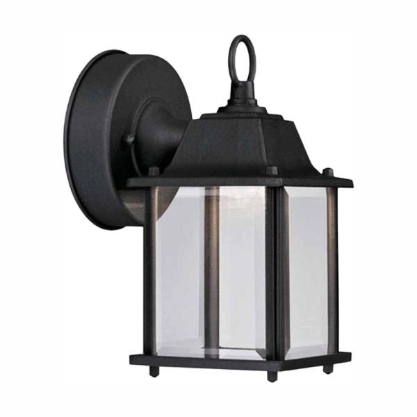

What type of fixture is it in? Most exterior fixtures have some level of metal construction to them that surround the bulbs in them. These act as faraday cages that play with the signal. Can you provide pictures of the fixtures? That is also an important piece of info needed to help troubleshoot here.
Here you go. Cheep little things. Glass on 3 sides, does have a metal back. Open bottom.
Mine are white & router signal comes from below & right side.
