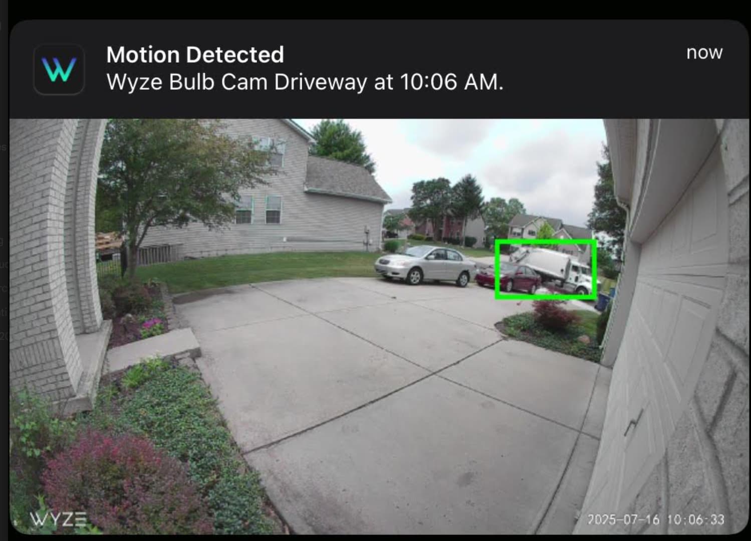

Re Detection Zones
What is going on - why am I getting a notification for this truck which is CLEARLY out of the detection zone?

Detection zone can be finicky. The green box is awfully close to the edge and it may be just enough to trigger motion. You could try excluding 1 or two boxes right below where the green box was and see if that helps. If not perhaps try a “reset services” or maybe even factory reset the cam and start over, something may not be “taking” properly.

The Motion Tagging box is definitely close to the Detection Zone:
It’s not extending into the zone in this particular frame, but when you watch these videos you often see the green box shrinking and expanding as the target motion moves, so it’s possible that the box was larger and extending into the Detection Zone in an earlier or later portion of the event. I’d consider enlarging the exclusion area (i.e., making more squares grey) to try to give the Detection Zone more of a buffer. You could also slightly reposition the camera itself (manually pan or tilt) if you want to get the grid shifted to a more ideal position for what you want to capture, because those blocks are so large. This trial-and-error tweaking process seems to be one of the trade-offs for not subscribing.
