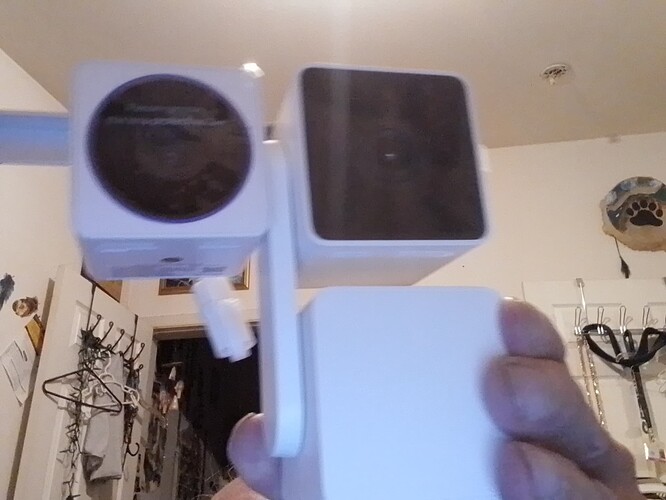

First tried it on top, but that gives trouble with the vertical engine, but i thought, why don I try it on the side… and that works perfectly.

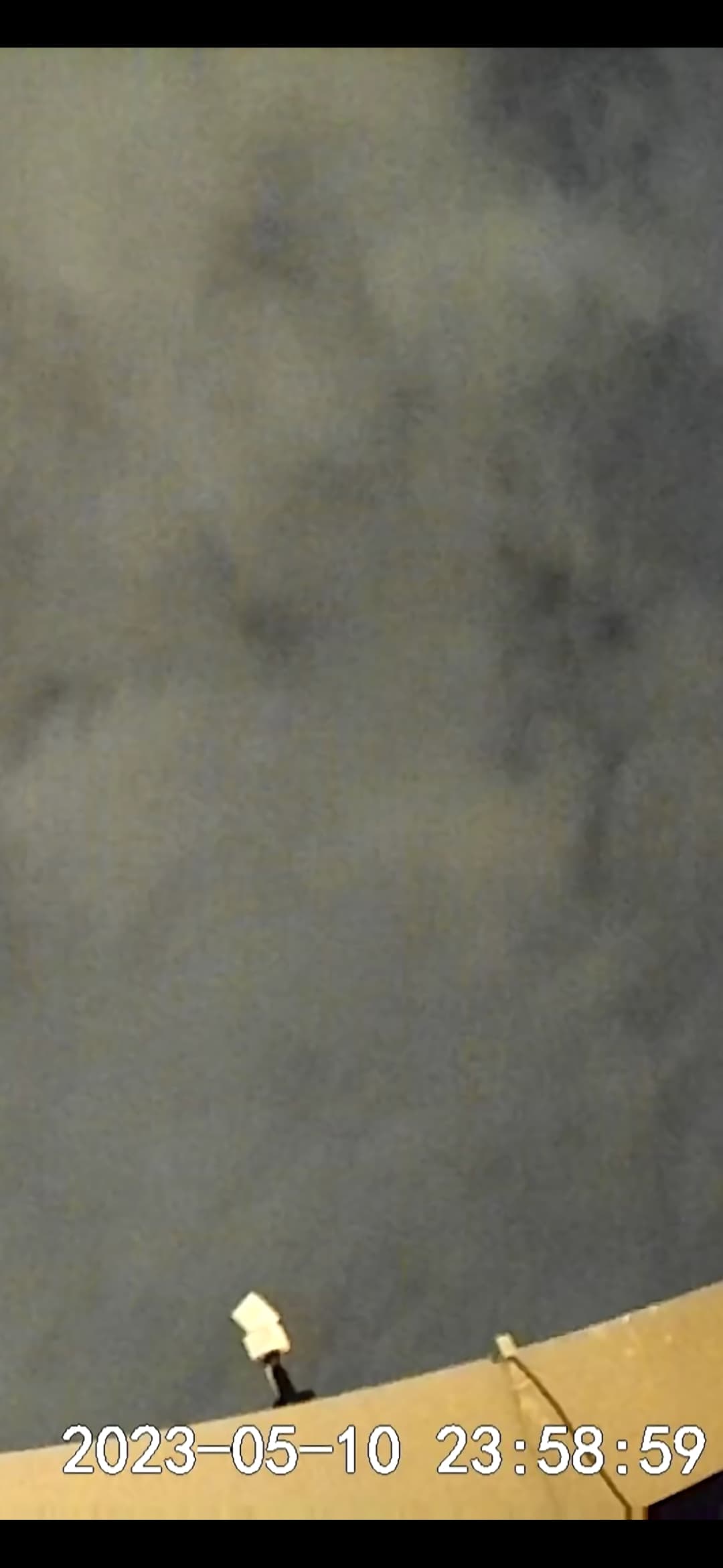

Thanks for the explanation, i use a mount for the netatmo wind and rain gauge, that fits the cam pan 3 perfectly, i try to find a picture as it is on the roof, the second one is on a pole of the fence
A bit difficult to see as the camera is on the roof

Positioning the og telephoto on top of the pan v3 makes it to dip the pan v3 when it points like 45 degrees upside angle, but when attached at the side it won’t, you can turn it vertically or horizontally without damaging or slipping of the motors. Even the privacy position works.
My definitive project works very fine.
Pan Cam V3 together with OG Telephoto.
I use a standard usb power cord that was with the OG, and I wrapped it around an iron pipe for a couple days , this way you get the spiral cord for the OG, the normal spiral cables with an micro usb connector are to tight for the motors of the pan V3. I use a second phone or my chromebook to control the motor directions and watch the OG to see if it is pointing the right way.

I have a new way of attaching the Wyze Cam OG Telehoto to the Pan Cam V3. By using a piece of aluminum angle extrusion across the arm holding the Pan Cam, I believe I have come up with a way that will minimize the strain on the servo motors. It should be better balanced. I just now got it together and it is untried, but I think this would be the better way to do this. It allows full movement of the camera up and down and should also be less obstructive in tight spots for rotation. I will let you know later when I have finalized the set-up and tried it out how it works. I also got a smaller piece of white plastic extrusion angle that I will try, It is smaller and matches the color of the cameras. So if it works, I will go with that, and it should also look cool.
UPDATE: I tried the smaller plastic angle 1/4” x 1/4” x.05 thick and found it too weak. It had a slight twist between the cameras throwing them out of alignment. I may try another wider and thicker plastic piece, but for now I will try the 1/2” x 1/2” x .062 thick aluminum and cover it with white tape or paint it. For now it is attached with clear double sided tape. Once I am confident with the set-up, I will probably glue it.
See my post below, you might like this way better.
Unfortunately, the name of the company who makes it is not there, no marking at all. I got it from work many years ago. I have not set it up permanently yet, The double sided tape is just for testing, but it is holding well so far. Probably any good name brand tape will work. I have thought of glueing it or maybe some tiny screws but I don’t really want to drill into the cameras. I still have to trim the angle down to fit.
