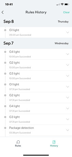

So the problem is that the bulb turns off at sunrise and not at 5am? What does your rules history show? Account -rules -history.
Again, G2,3,4 went perfectly as expected. They went on at Sunset and off at 10pm. G1 on the other hand was scheduled on at sunset as it did and off at 5am which it did not. Instead it went off at same time as nearby V3 which was set to Auto night vision mode meaning night vision is set to go on at sunset and off at sunrise as it always does.
My only conclusion is that somehow the V3 is influencing the smart bulb which really doesn’t make sense to me but it’s what seems to be happening due to close proximately as I mentioned.
According to the history, something happened to g1 at 5am. Click this to show what ran at 5am and show a screen shot of that:

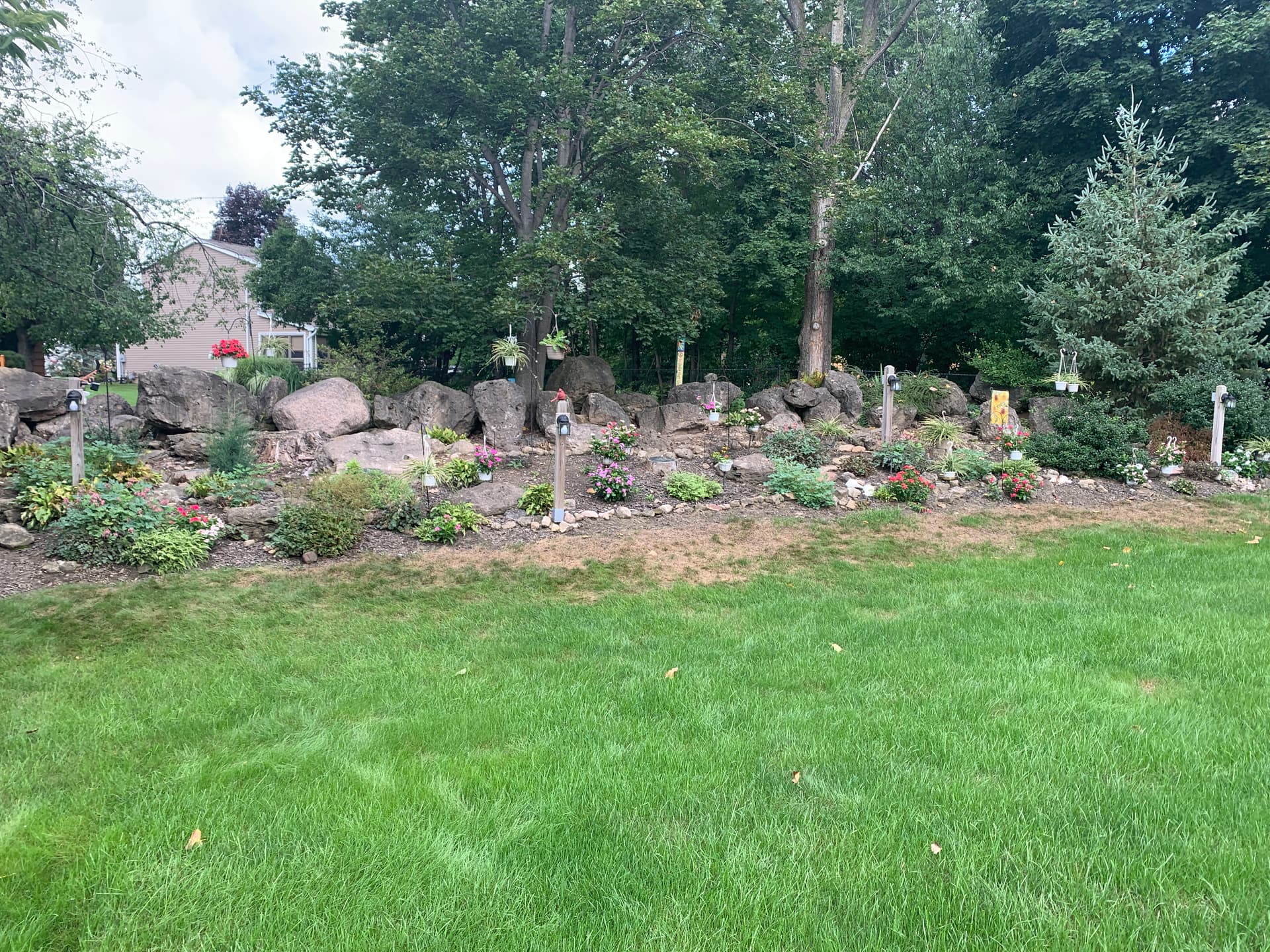

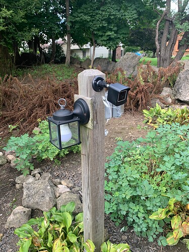

I’m sending you a few pictures to set the stage. This one is G1 and the V3 in very close proximity. Next will be all 4 lights.
This is history saying that G1 turned off but it did not ( until exact time that the V3 switched from from night to day (full color). I know this because I set continuous recording overnight.
The night vision changes on the camera are probably due to lighting changes from the bulb

You didn’t break down and open up the 5am line. Click where I arrowed above to open that line and show what occured.
