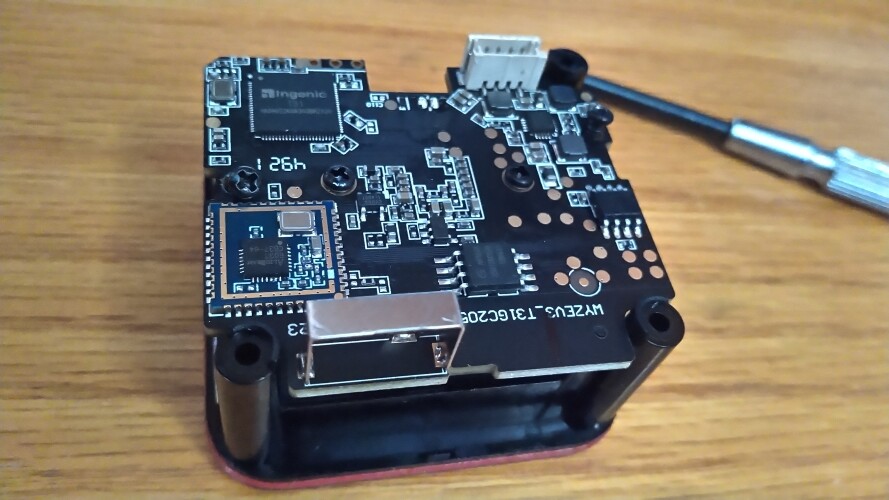

The front ring will need to be pried off exposing 3 foam plugs over the screws that hold the camera in the body. They can be pried out with a needle of jewelers screwdriver. The screws fit my #1 phillips.
After removing the 3 screws you need to gently pry the camera out of the case. Careful there is a gasket around the cameras assembly. Show in orange. Then remove the 2 wires from the camera. Pry carefully with a jeweler screwdriver. (Sorry poor case picture. )
The 2 connectors are plugged in to the 2 spots on top of the camera assembly.)
Remove the 2 screws on the left and right of the board in the picture. Both are sitting loose in the picture.
The lens is glued into place. It is snug. I held the board firmly and used pliers to break the lens loose. It will snap and come loose. At your own risk removing it.

When you thread in the new lens. The threads are very fine. So careful you do not cross thread them. The new lens was pretty snug, I tried the old lens and ran it down a couple times and made installing the new one easier.
Careful with the lens removed you do not want to get any dust on the sensor. A good idea to work on a clean area where a tiny dropped screw is easy to find.
The new lens does not have to go in very far. Maybe threaded in less than 20% of the way. The hardest part I had was focusing the lens. You have to hook the wires up to the camera while leaving the screws out and turning the lens to focus it. I had a 20 second lag time so it was a challenge. Take your time.
Once all in focus reassemble the unit back together. It looked like there was a light film of grease on the orange seal to keep it water tight.
