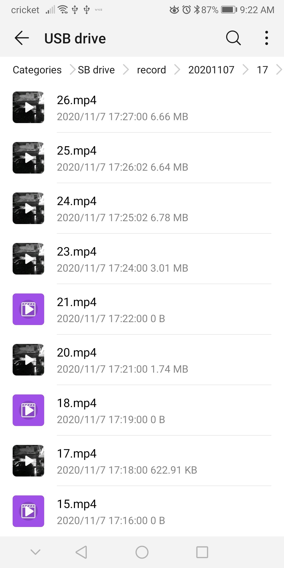

i want to check the wyze camera in the garage and was told no video at this time, this is [Mod Edit] , wyze!
[Mod Note]: Post edited to conform to the Community Guidelines.
You have an issue with your SD card, click Format. If it fails, remove it and format it with a computer.
The capacity listed is not correct.
check sd on computer
it stopped ten days ago, then recorded a few on 11/7
even when it recorded, there are some with zero size, some are non-continuous, e.g., skip 16.mp4 and 19.mp4
there is no way that u can find that it is not working properly until one day u need the video…
The are different types of SD cards, some made for video recordings and most for data storage. Video cards have unusual demands because of the constant cycling. I switched my cams about a year ago and have had no problems since then.
It is very possible that your card is developing read/write problems. There is a lot of info on continuous recording that video cards like the ones in our cams are subjected to. Standard data cards are not designed for it and develop problems, and the cards sold by Wyze aren’t High Endurance cards. I switched several of my cams months age and a number of oddball problems went away. In regard to formatting the cards, best practice is to format the card in a laptop device using the program below and the Full or Deep option which will overwrite/repair any bad tracks which the camera option will not. Here are some resources:
