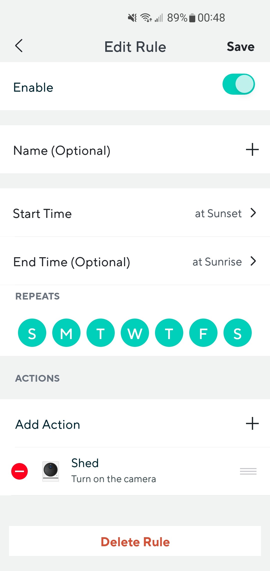

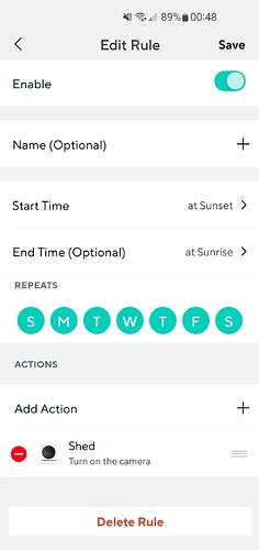

So I set up a rule for my Shed camera V2 Outdoor on CamPlus. Start time at Sunset and End time Sunrise. with Action Turn on Camera. I set up the location data for it to know when sunset and sunrise was,
And 2 nights in a row it has not come on. Am I doing something wrong? Please help! I need to automate this to come on at night and go off in the morning. Thanks!

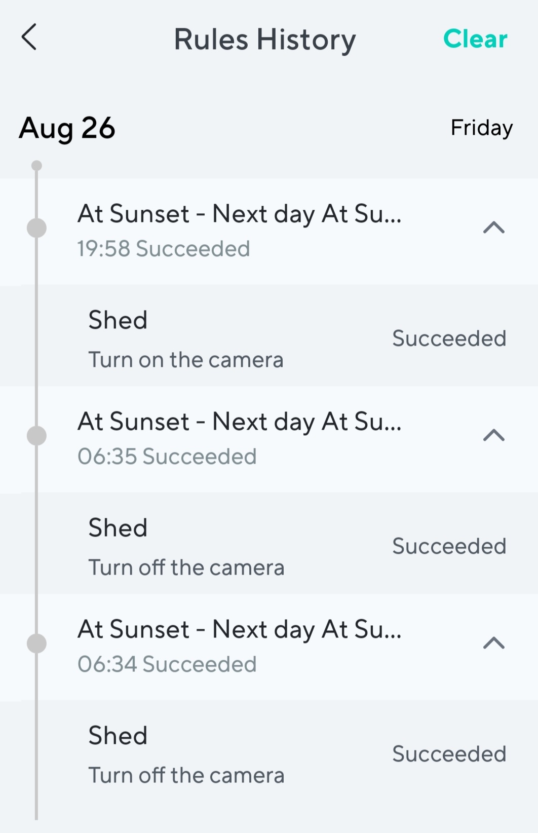

Check the rules history in account > rules > history. See if it said it failed and why.

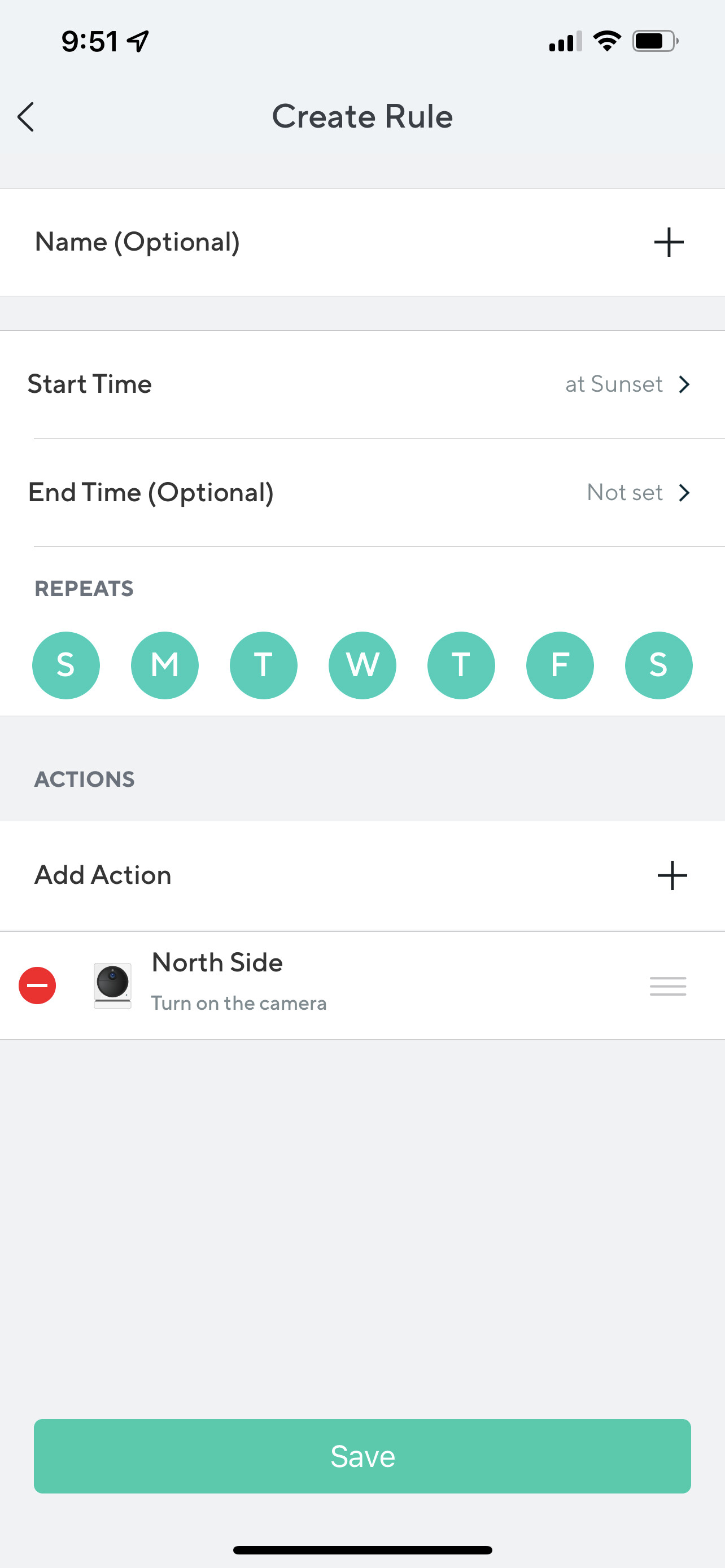

It’s stating it’s succeeded. But I think I have the rule messed up, but it’s a very confusing setup. The rule is setup as follows;
Start time - At Sunset
End time - At Sunrise
(Both have my location setup)
Repeats every day of the week.
But then I am forced to add an action. It can’t be saved without doing so. This is what doesn’t make sense, because I can either set the action to TURN ON or TURN off. I can’t set the action for TURN on for rule at Sunset and Turn off for the rule of Sunrise. So is you check the screen shot of the history it just seems to randomly turn it on or off for Sunset. I don’t get the way they have this set up it makes no sense to not be able to add an ACTION to each rule? ( Sunset ON and Sunrise OFF ) and can only set ON or OFF for the Rule itself. I am just confused.

What you have is every day of the week turn on the camera at sunset and then at sunrise the camera will turn off.
Your rule history shows that the camera is turned off at sunrise and on at sunset.

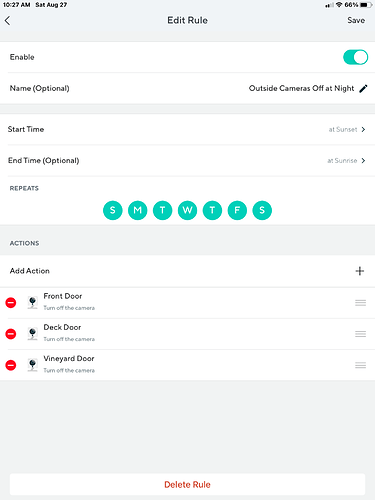

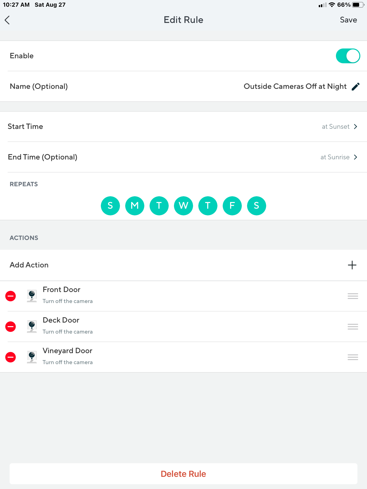

Not sure why that is true. In theory, the rule from OP SHOULD work, or at least that’s how it’s been described in other posts. I have a rule to turn my inside cameras on/off overnight that works. It uses times, rather than sunrise/sunset but that shouldn’t matter.
Here is one using sunset/sunrise:
Yea I got learned :grin:… I’ve been stuck in my old way of doing things or just thinking there was no reverse method to the on/off schedule rule.

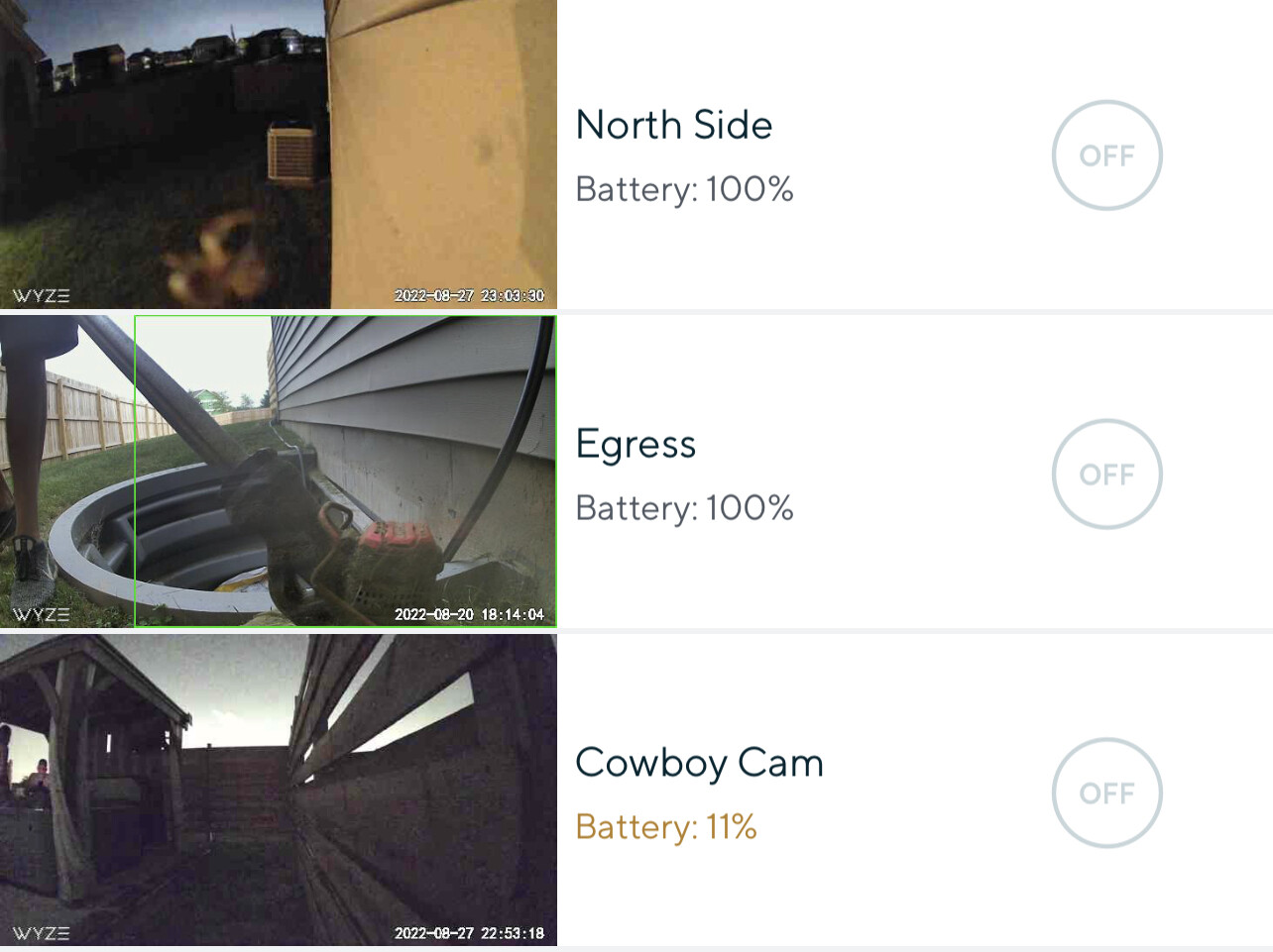

Tested with a hard time rule for now.
WCO V1
2 WCO V2s
1 V1 and 1 V2 with Solar Panels
1 V2 Without Solar Panel
Cameras were off
Rule fired
Cameras Came On
Will look and see if they go off in the morning

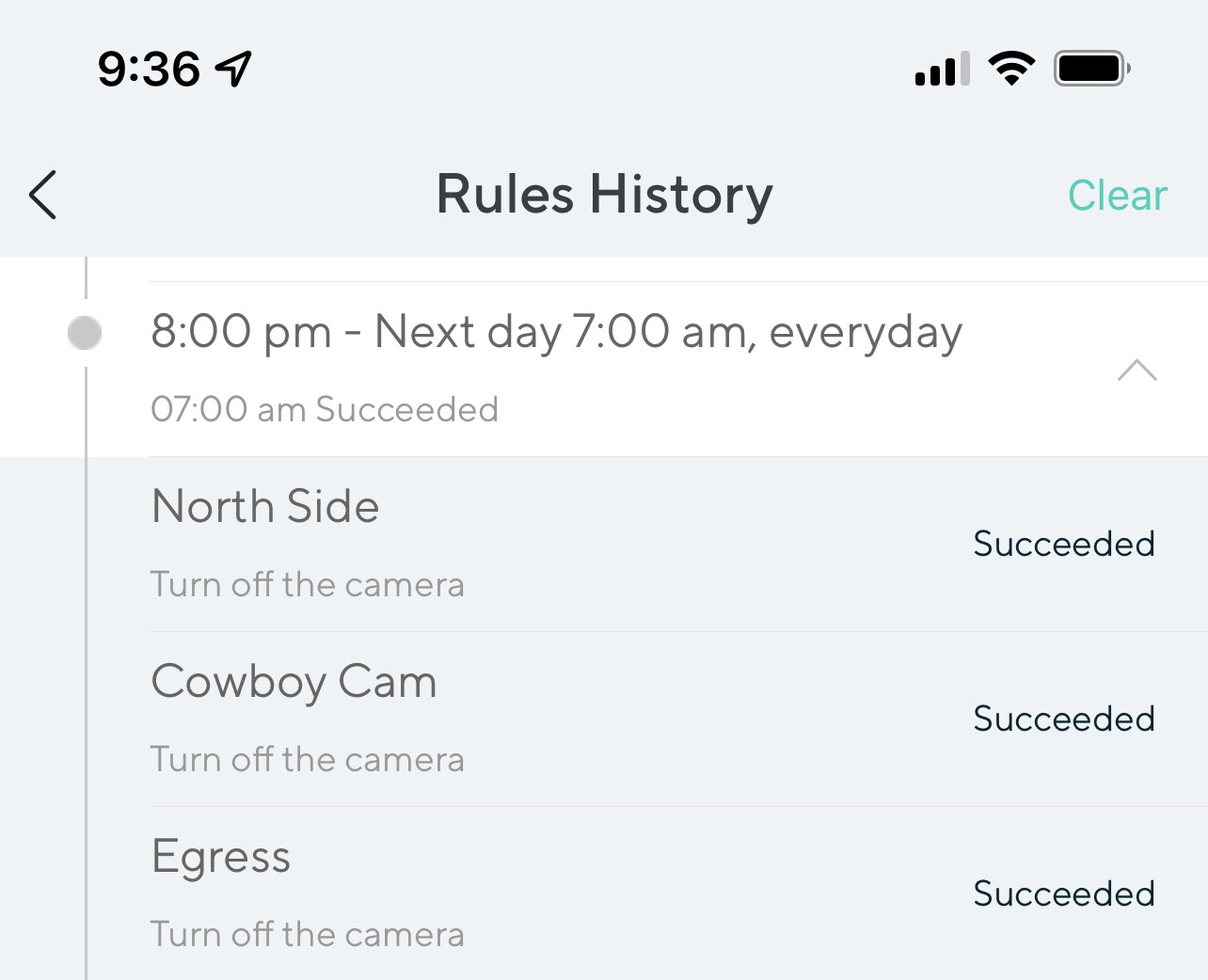

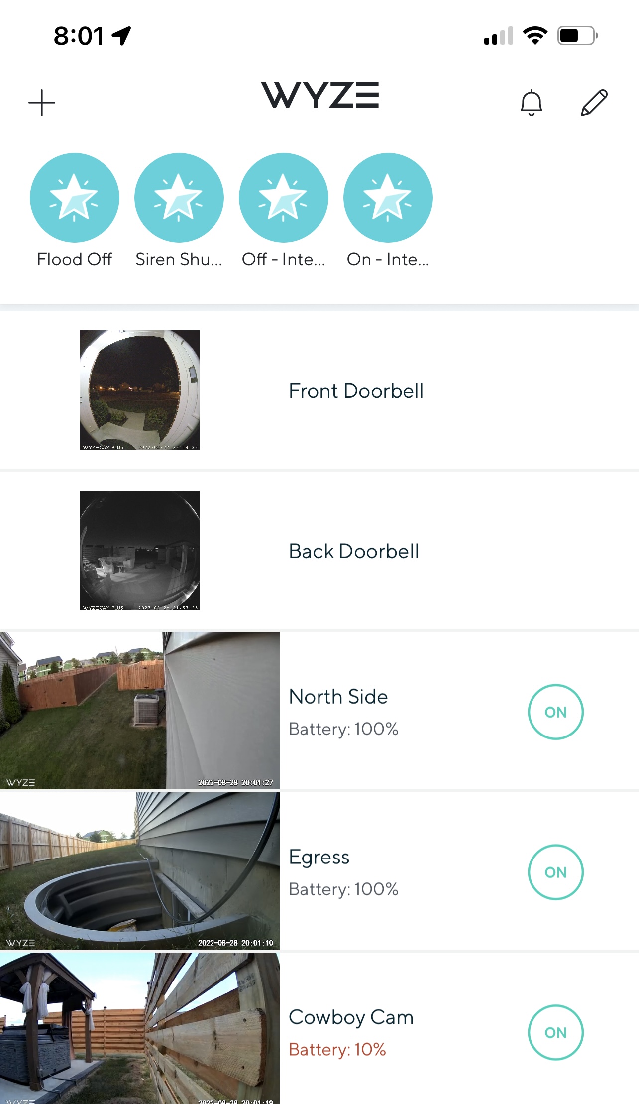

And as a follow up, the single rule with hard times (not sunrise to sunset) did turn the cameras off this morning.
New update. Cameras came on with the schedule again
@mhinc try your original rule with set time near sunrise and sunset rather than the 2 rules and see if you get the same results
I am swapping my test to a sunrise/sunset rule now to see if they fail or succeed .
