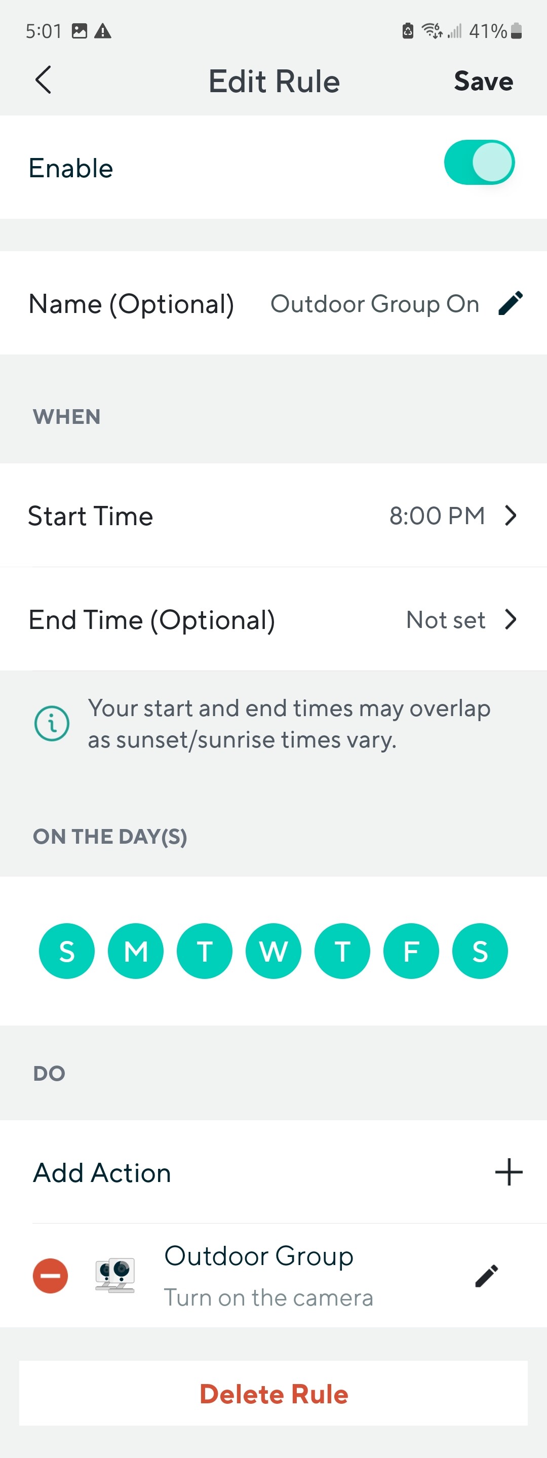

Meaning the I have my cameras (all of them V3’s and the one Outdoor Cam V2) on a schedule to turn on at 8pm and turn off at 8am daily. The only other rule I have set is Away On which turns on all my cameras whenever I leave the house. I am at home all the time everyday so only when I leave do I set them to the Away mode/rule and all other times they only turn on for 12 hours to record events only during the night 7 days a week… I hope that explains what that means and is helpful… My cameras are NEVER used 24/7 and I do NOT use continuous recording on any of them. Motion events only.
**I should note that I also have Blink outdoor cameras as well that do run off of solar panels and I never have issues with them at all. They have worked flawlessly for years with the solar panels. Only this WCO camera will not charge (only discharge using a solar panel)… So something is definitely not right here…
Could you provide screenshots of the rules? There are many diffrent definitions of “turn off”, and a screenshot will help confirm what type your using

It’s pretty plain and simple like I said but here’s the images that you requested about the rules…
