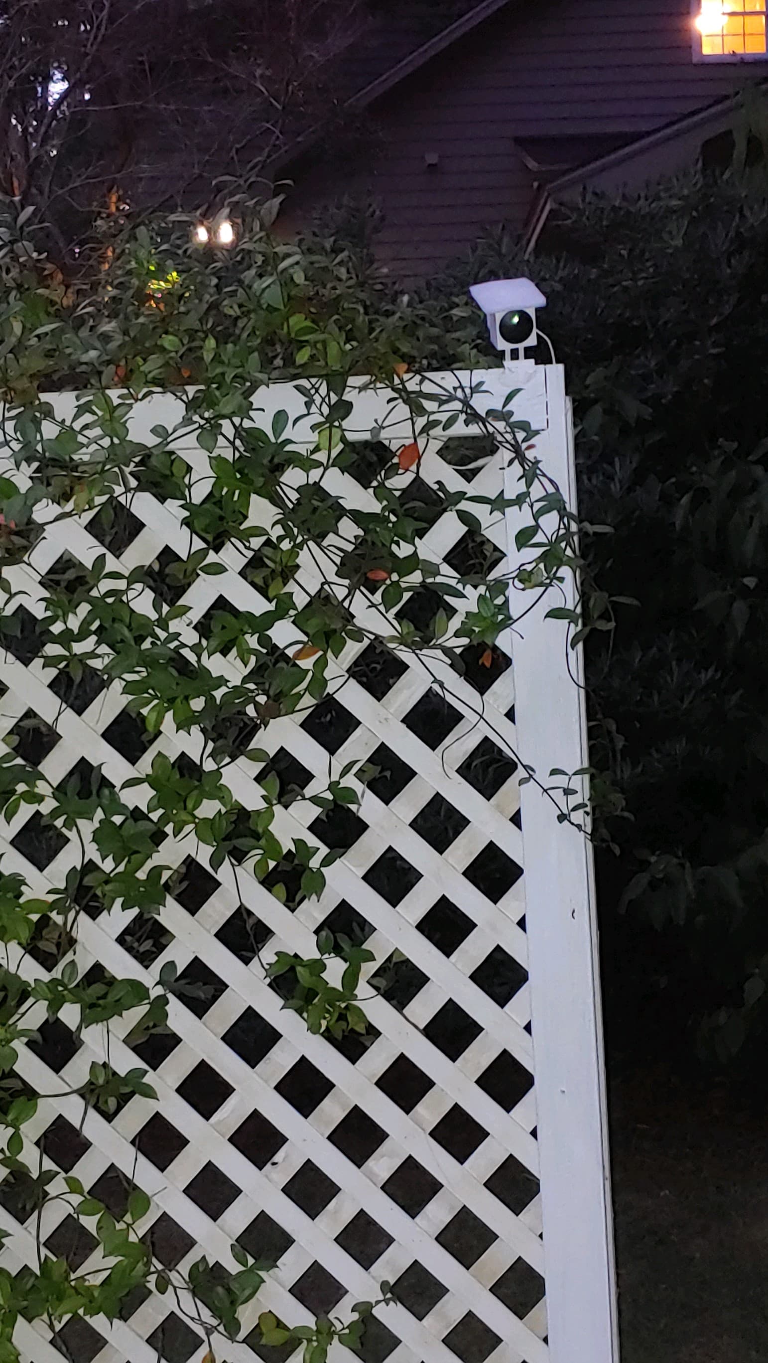

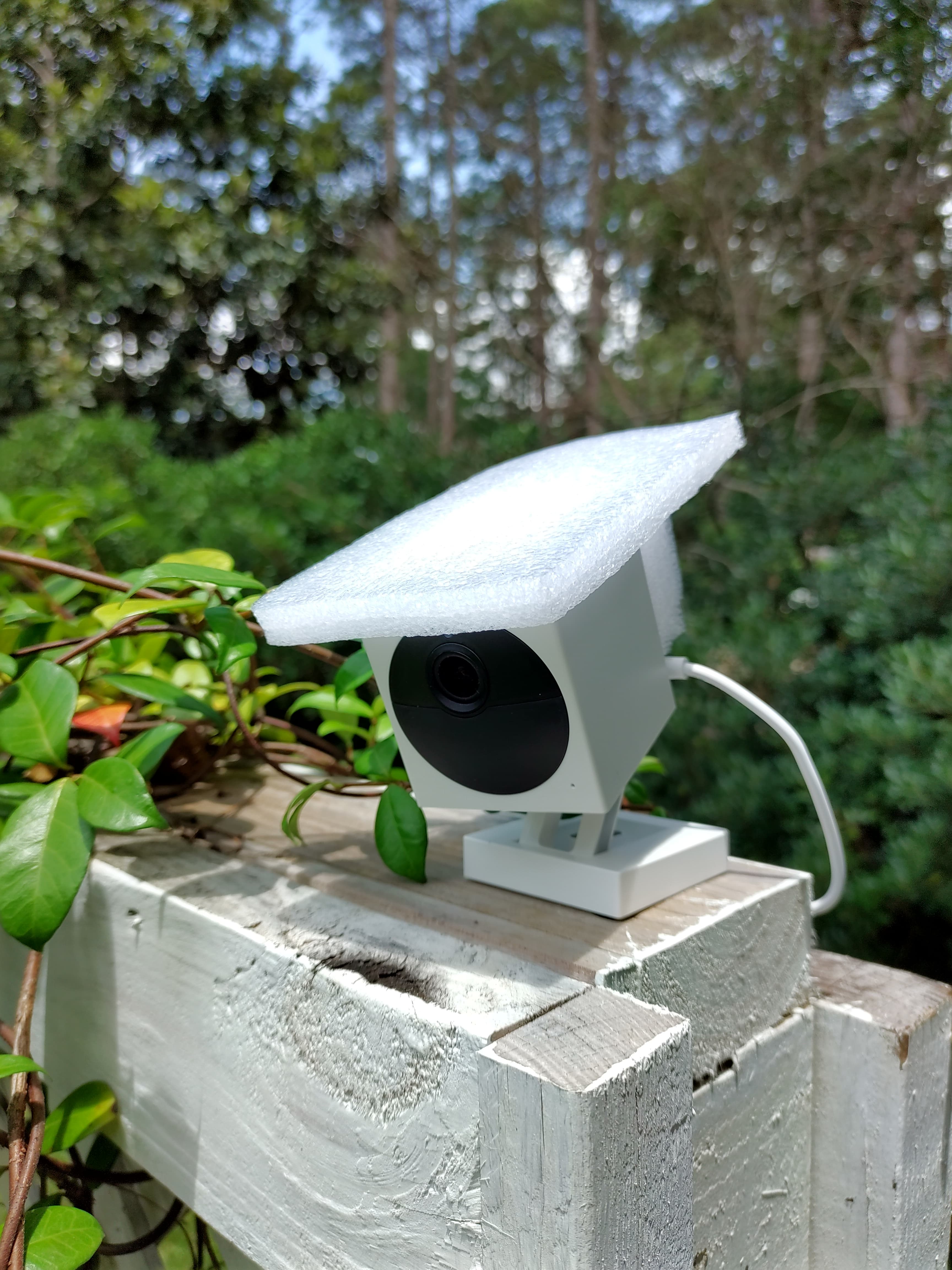

EDIT-2: I’ve also placed this rig atop an outdoor trellis where there is plenty of sunlight during large chunks of the day. Affixed a small styrofoam hood on top of the cam itself (gorilla tape) in the event of downpour or careless birds :smile:

I really like your setup with the cover on the camera. I wouldn’t have thought of that and it’s very proactive before you have an incident and have to go clean the camera. Great idea!

This was my first inclination as well. I had my mom walk out to pay these devices a visit prior to the weekend (Thursday or Friday nite) and everything still appeared as clean as when I deployed it on June 9th. Here are the pictures she took to confirm:
