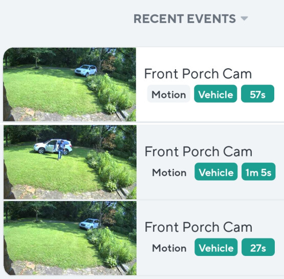

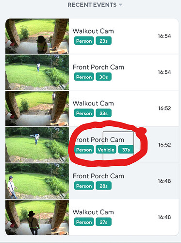

I tested with Person and Vehicle detection on, then drove my vehicle into the Cam V3’s field of view. No notification of vehicle detection, but if I get out of the car I get person and vehicle detection combined.
I then turned off Person Detection, leaving only Vehicle Detection on and drove the vehicle into the field of view and Cam Plus triggered Vehicle detection ONLY.

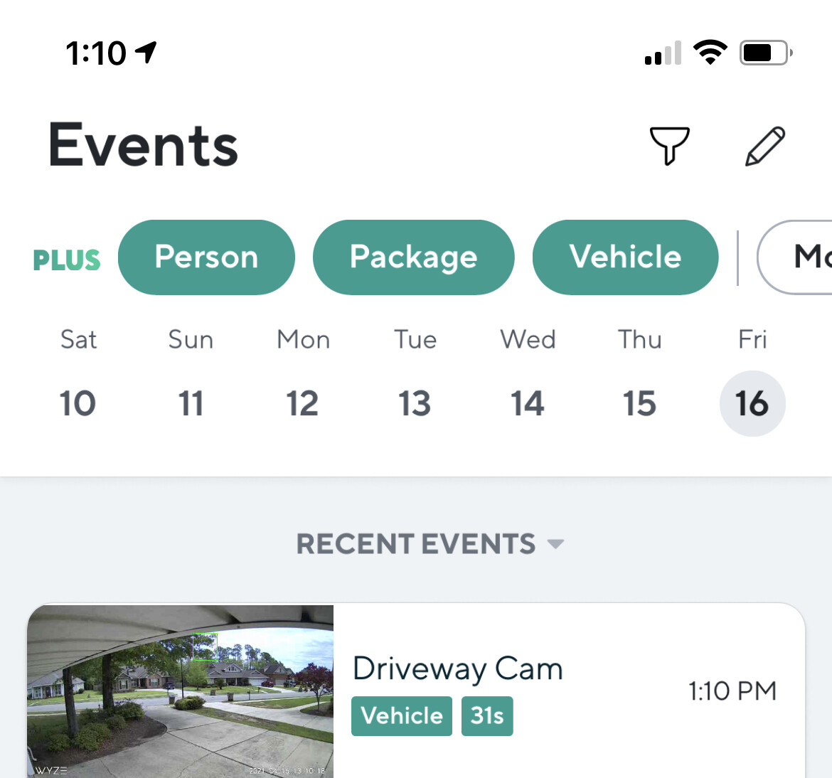

Are you adjusting the camplus settings in the camplus Services menu, or are you adjusting the event tab display filters? Your screenshot is of the event tab. for troubleshooting and testing remove all filters from the event tab so everything is shown.
Yes, adjusting settings in Cam Plus Services menu.` I am not adjusting any display filters whatsoever.
I illustrated the issue using the event tab since it showed all relevant information. Namely, Picture of the initial event and what triggered the events, Person, and or Vehicle.
If Person detection is enabled and Vehicle detection is enabled, Cam Plus cannot detect only the motion of a vehicle in the field of view. If a person moves into the field of view that contains a stationary vehicle then it will show both Person and Vehicle as detected. Vehicle only movement in the field of view in this scenario does not cause a vehicle detection event to fire.
If Person detection is disabled and Vehicle detection is enabled, Cam Plus detects the movement of a vehicle into the field of view. Since Person detection is disabled, only vehicle detection is possible in this scenario.
Note: Sensitivity settings were not changed between #1 and #2.
This appears to be a detection logic issue when both Person Detection and Vehicle Detection is enabled, since Vehicle movement only detection is not possible with these settings.
