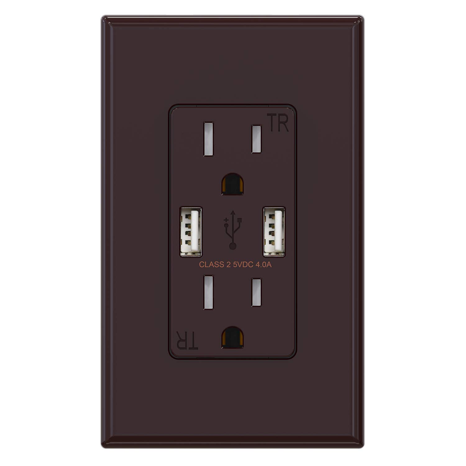

A better solution would of course be to install a wall socket that has a USB output, and then there’d be no need for the adapter.
Can I do better ? Are there smaller wall plates that have only a single USB output ? And if so, do they have an integrated 120V->5V transformer ? If not, is there a safe, in-wall, 120V->5V transformer available anywhere ?
Thanks.
I see a fixture with four USB ports (no AC outlets), or an fixture with two AC outlets and two USB ports. But a single USB that fits a standard electrical box would be rare.
There’s a modular setup with a single USB but it’s only 1/2 size, so it requires a standard electrical box plus some other module (another USB or an AC plug)…
Almost all USB wall outlets that have power outlets are already adapted for USB charging. I would just get those, and insert outlet covers (used in baby proofing) on the power outlets.
I used a 2-110 and 2 USB setup from Amazon. Standard size, looks almost like a normal 110 but has USB also - no need for adapter-just plug in usb cord. Available in colors also.
