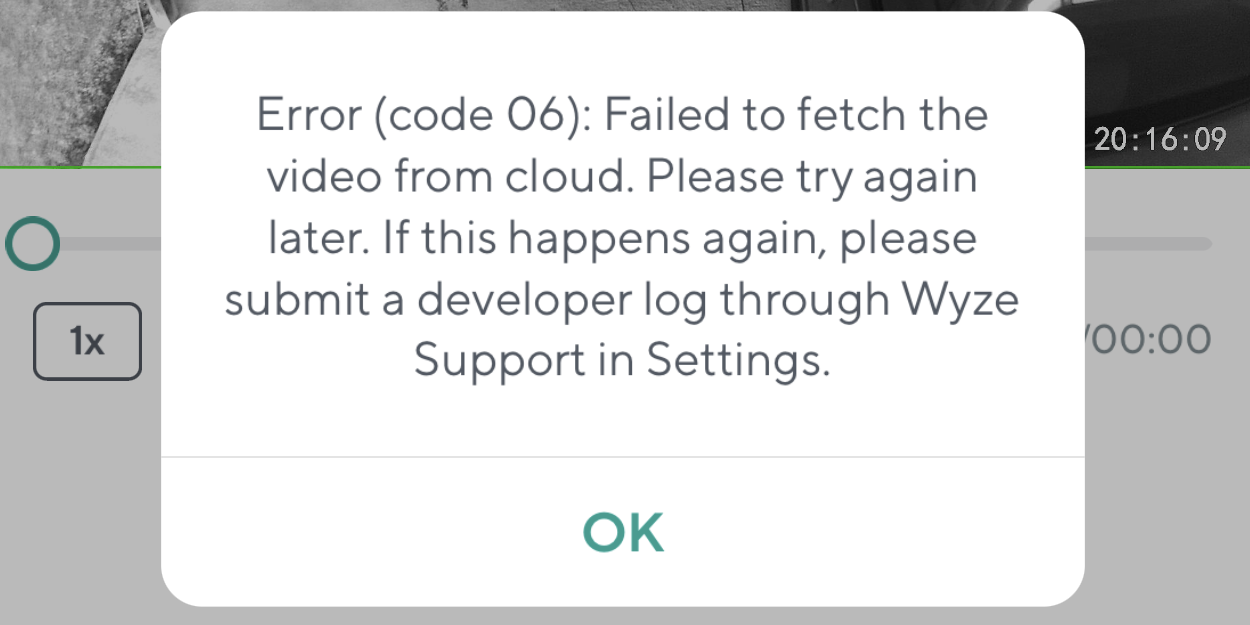

I’ve recently been noticing quite a few of these same errors myself when browsing through events. It seems to happen on the shorter videos (10s or less) for some reason, so I can almost tell which ones will have the issue:
I have started submitting logs and screenshots such as the one above almost every time I get the error now as it’s starting to annoy me that I’m paying for CamPlus and this has started happening daily.
