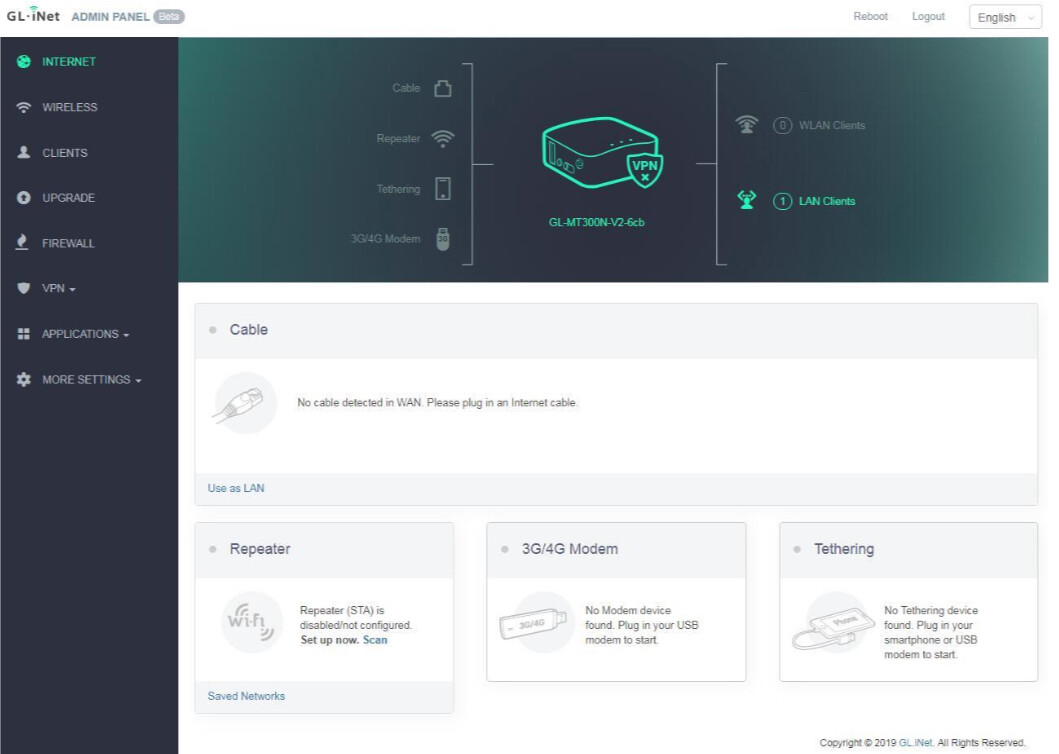

This is what the main Admin screen looks like since 2020 and the Repeater Option. Direction are also slightly different since that was written.
