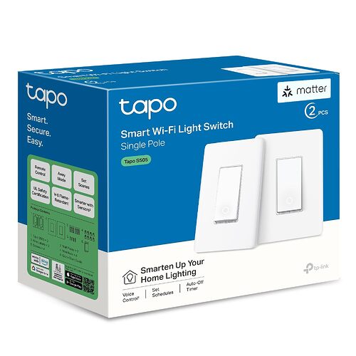

Even better deal 2 for $18
All I am trying to find is a remote control “toggle style” wall switch to control a single overhead light. The switch I want to control is a single switch in a box with 2 or 3 other toggle switches, each of which controls just one thing in the room. Numerous companies make Decora-style controlable switches. The one you referenced is a good price, but it doesn’t work with a box that contains three other toggle switches.
It would with an appropriate wall plate, as I noted above (provided you have a neutral wire):
