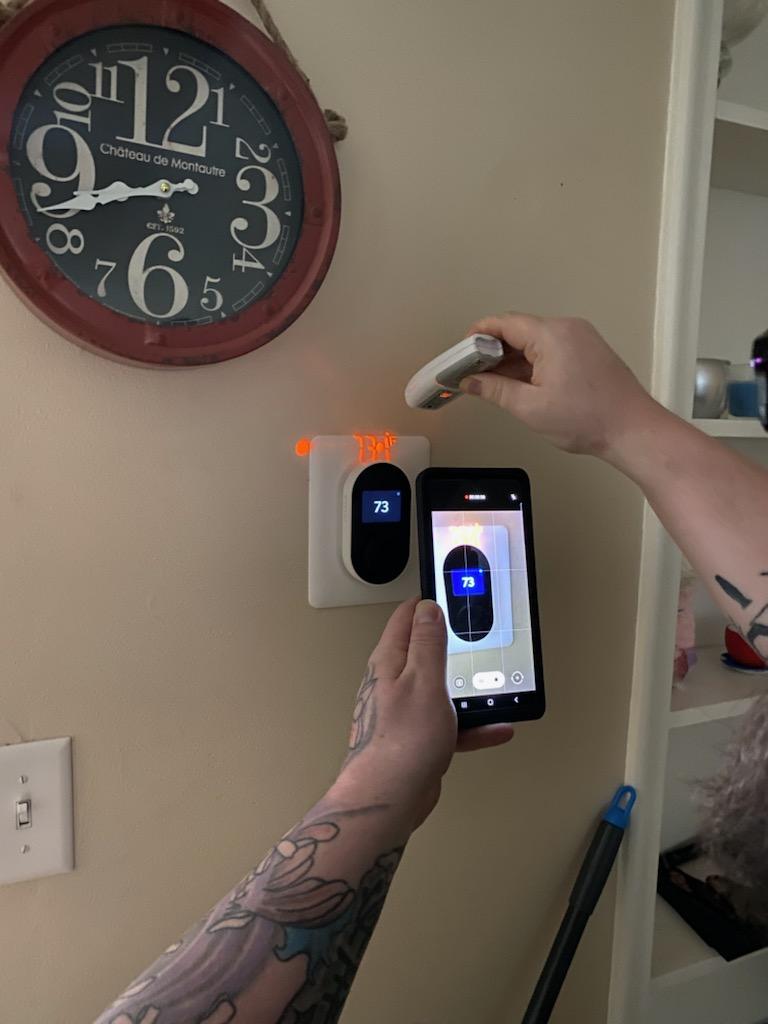

I have discovered a weird issue with my Wyze Thermostat. I have noticed that at night it wasn’t kicking on the heat as I have it set to, which is set to 68. I would regularly see it showing 64 or so and I would need to manually adjust or use the app to turn up the heat… This is the first of my issues.
The following is something I discovered this morning. The images were taken while I recorded a video.
What I can show is that the surrounding wall shows a lower temp than what the thermostat shows. The closer I move to the top of the thermostat, the closer the temperature gets to the displayed temperature.
Usually a difference of 5 degrees.
Can anyone help me with this?

Images attached. Thank you so much! Video may be too large.

I monitored my Thermos with an external device and found both of mine were one degree cooler than the room and adjusted this under the advanced options “temperature correction”. 5 degrees is a bit wide but the environment can be a factor, vent, windows, doors, etc near the thermostat or is there something on the backside of the wall warming the wall up near the thermo?

We have seen the wall penetration for the thermostat wire allow a small airflow through it and cause thermostats to have high or low readings. You could remove the thermostat and try some plumbers putty (or something similar) to seal the penetration and see if it has any impact to the performance.
