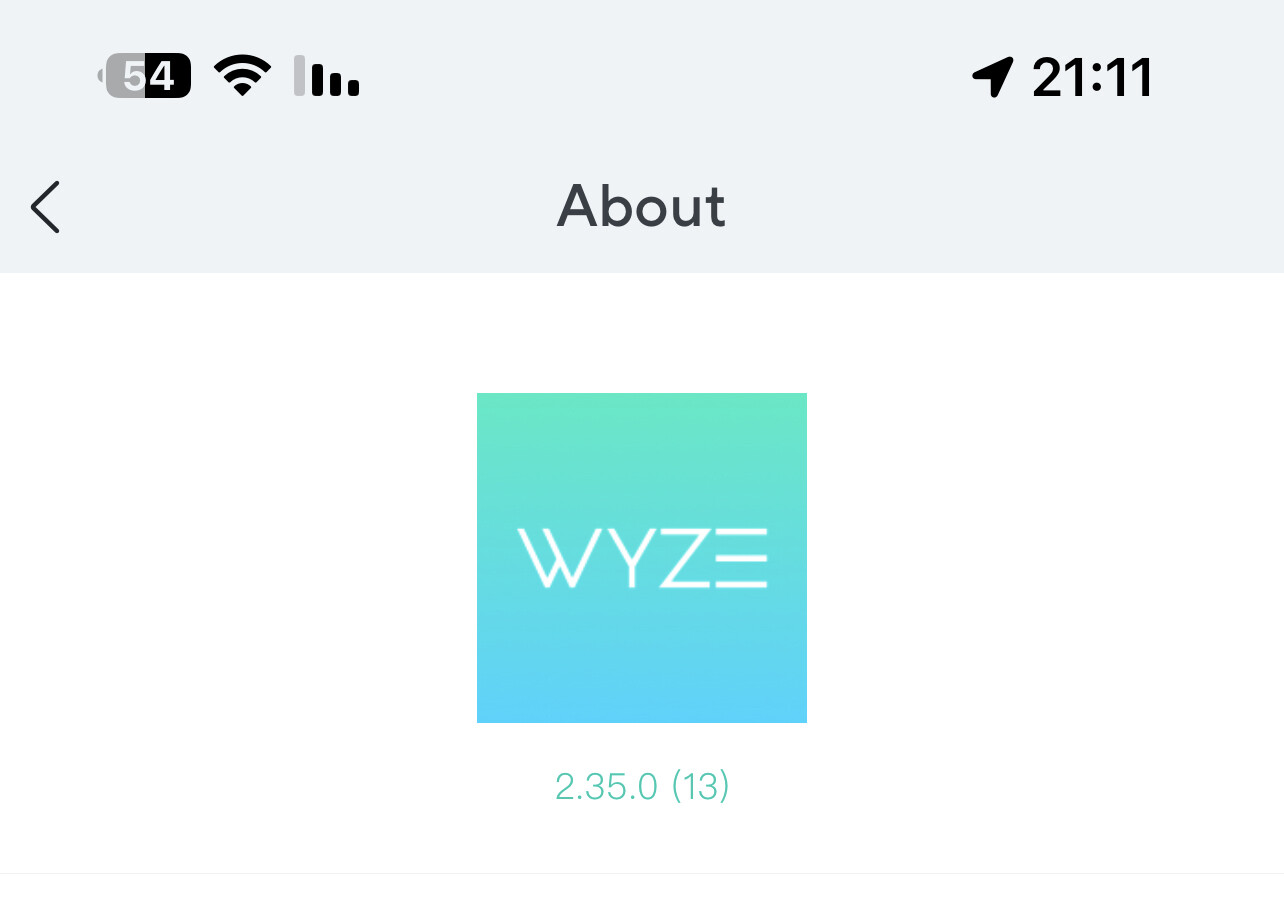

That’s unusual looking. Since it has a Sharing menu item, I assume this is the primary account. What app version are you using? (Account tab > About > Look under the Wyze logo)
Hi ,
Here :
That’s the current version for iOS. So if you go into the V2’s Device Info menu item, what version is the firmware?
