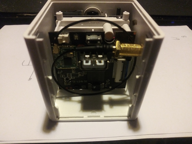

I destroyed a V2 camera after ordering the recommended lens from Amazon. LoL. Ended up breaking the black WiFi wire on both ends. Wasn’t sure how to remove the connector from the circuit board. Should have lifted it straight upward, but the wire came out of the teeny tiny connector. Used dental tools purchased from a surplus store to open up the metal tangs on the connector and mash the wire back in place. Got it all back together and had forgotten to set the focus. Disassemble. Break the other end of the short WiFi wire from the antenna. Considered buying a soldering gun. Remembered I gave away the last soldering gun due to lousy soldering skills. Concluded after a few hours that I was wasting my time. Maybe next month I’ll experiment with another camera. Couple lens swap videos on youtube which others put up are pretty good.

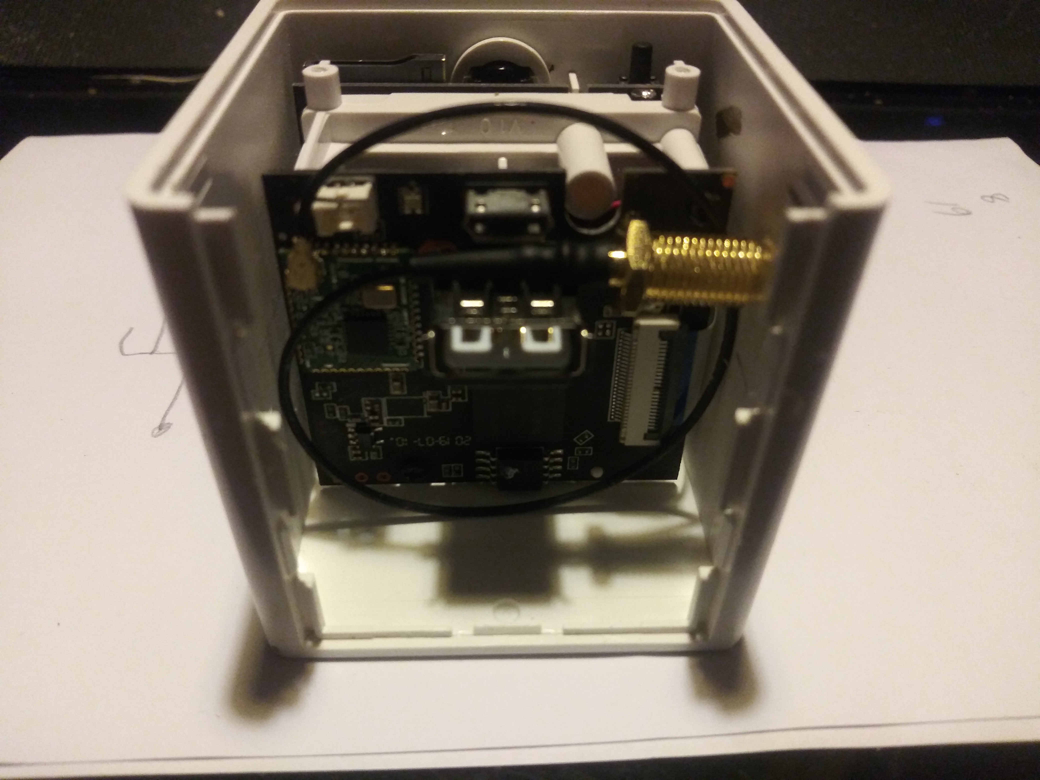

I go ahead and pop out the black part on the case around the lens, which allows you to fine tune the focus after everything’s back together. You can pop it back in place from the outside later. As far as the antenna and wire, the connector size/term to look for on amazon is “U.FL” (because there are different sizes that look alike in the pics). If you go for an external antenna like me, there’s an exact spot to put so that it doesn’t interfere with anything, and so the wire lines up between the usb connectors.
btw, Anymore I just peel the flat antenna off the inside of the case because it’s such a pain to reconnect the wire. It’ll stick right back.
Thanks for the tips, I never would have thought to consider replacing the antenna. For the possible future benefit of others, be really careful when disconnecting the U.FL connector from the circuit board. Lift it straight up, possibly with light pressure using needle nose pliers. And don’t flex the end of the wire which is attached to the self adhesive antenna sticker because you can easily break the connection. Consider taking photos of your disassembly work because you might forget which way something goes back into place. The screws are teeny tiny and easily lost. I used a refrigerator magnet to keep them together / from getting lost. Magnetize your screwdriver ahead of time. The screwdriver I use on my eyeglasses worked great. One of the circuit boards has 4 screws which need to be removed. Don’t initially remove the 2 screws which pass through a brass fitting (you can remove them later, after the circuit board has been removed from the case). As others pointed out, you can snap the large black plastic piece out of the body to facilitate focusing the lens (and snap it back into place upon completion). I took this opportunity to spray paint the body to match the trim colors on the house so the camera will blend in better. I await external antennas ordered through NewEgg.com because the shipping was cheaper than Amazon.

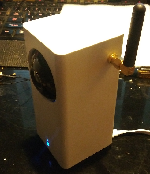

For the benefit of others who may order a U.FL external WiFi connector, make sure they’re shipped from a reliable source in the USA. I failed to observe at NewEgg.com that my order was shipping from Europe and it got lost in transit after a month. Which caused me to wonder this morning if a USB WiFi dongle could be plugged into the camera. I have a 2.4ghz dongle lying around and I’ll try that later, though I don’t expect it to work. I did get a soldering iron and completely fry the teeny tiny U.FL connector after burning my finger. Most likely I have reduced a cheap camera to Spare Parts which I’ll never need.

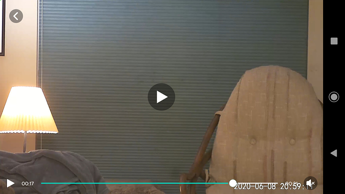

Finally received external antennas and finished a FrankenWyze. Screenshots of before and after views appear below taken indoors.
The distance between the camera and the front window is about 33 feet in both screenshots.
