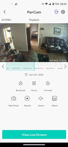

Hey everyone! I have a PanCam V1 and haven’t had the necessity to pull SD files for a bit so I did some testing. I am on FW 4.10.8.1002 using Android app 2.30.0.130. I have a 32gb Ultra High Endurance uSD running in the cam @ SD quality recording continuous.
@ajimbo, welcome to the community!
When I play a CamPlus Events tab cloud video event produced from the PanCam V1, and then press playback, the video from the SD card loads and plays the SD footage from that timestamp. It shows the SD footage on the slider in green, indicating recorded footage (I turn the cam on at 7am when I leave):
Screenshot_20220426-221657
When I launch the playback from the PanCam live view screen, and go to the same date and time, I get the same results:
I can scroll the slider all the way thru to when I shut off the cam when I got home.
I just turned my cam on to test this. Launching the playback from the live view shows that the cam started to record when I turned it on up until the current time:
