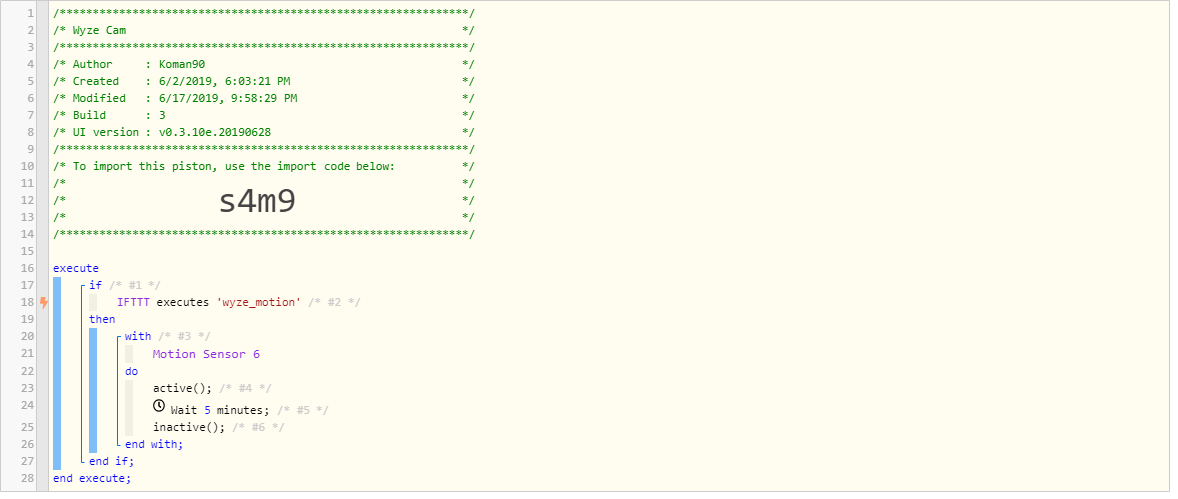

So, Since Wyze connects to Smartthings and so does IFTTT, i set to to see if i could make this work. With IFTTT as an intermediary.
I first logged into the Smartthings IDE and created a new “Simulated Motion Sensor”
I installed WebCoRE which support listening for IFTTT webhooks, and created a piston, with a 5 min delay, as that is how often the camera sends events.
I then created an IFTTT Applet that seends the web call to WebCoRE on the Smartthings hub
Success, I did the same for the smoke Alarm to, now the wyze cam will work with the smarthings home monitor, and as a motion detector for my lights.

Funny I just worked through the same process with my Wyze motion sensor, then came here to see if I should share this for others and stumbled across your post.
One difference which you may find interesting. I use a single piston for both active and inactive states. Still requires two IFTTT applets because of the options Wyze provided for IFTTT events, but kept things slightly cleaner in webcore. For the variable I’m passing at the end, one IFTTT applet will use “active” and the other will use “inactive”. I love these small sensors and may pick up a few more since this is working so well!
