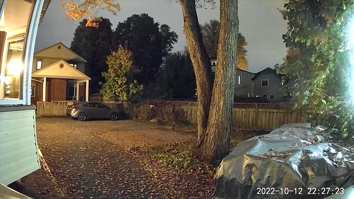

This is with the floodlight OFF

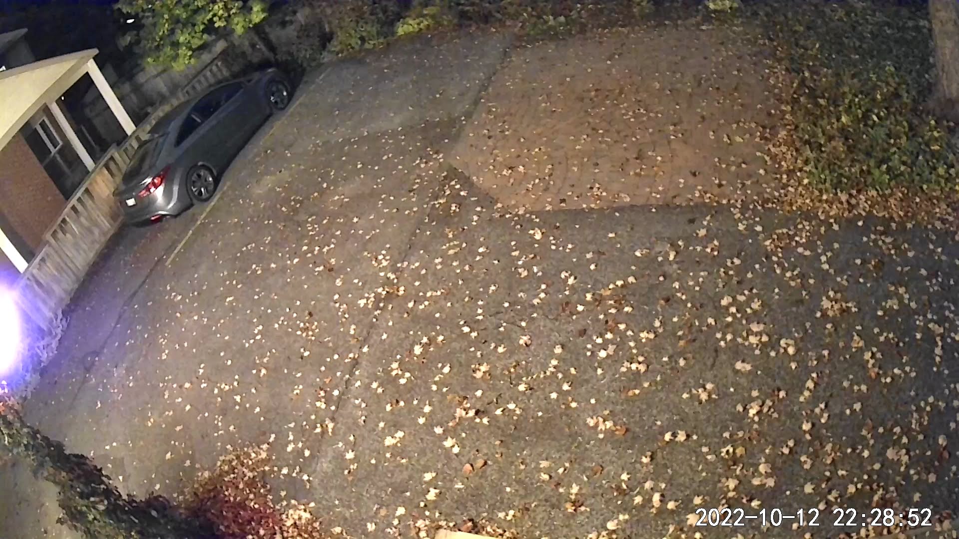

This is with the floodlight ON
Interestingly, to me at least, is that I have another camera (v3 that is indoors mounted against a window). Similar view from a different angle.
When the floodlight is OFF, it gives me a similar very good picture.
When the floodlight turns on, this cam continues to give me a good picture. Plenty bright with lots of detail.
So it’s only the cam on the floodlight that gives a poor picture when the floodlight is on.

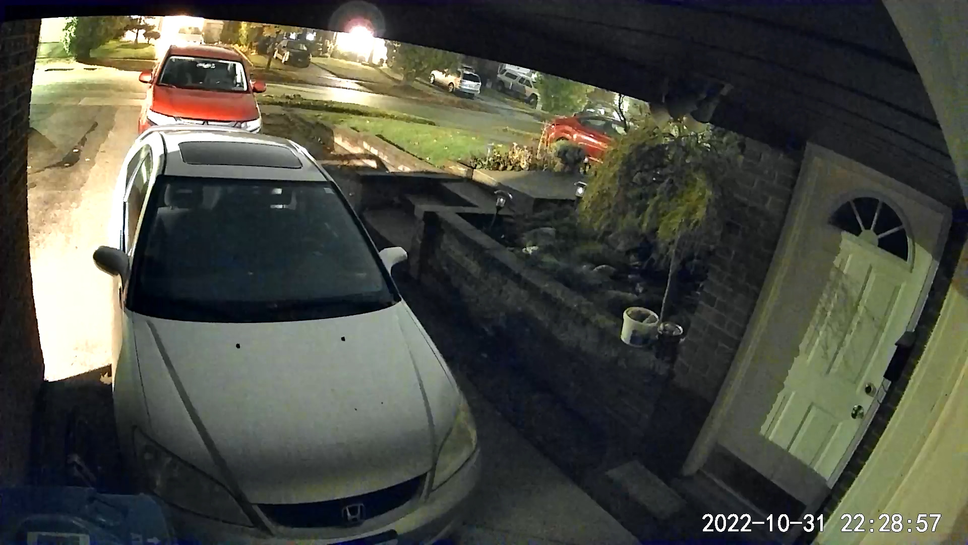

I don’t think that there is anything wrong with your camera. I think is the limitation of the Starlight Sensor. Here is screen shot of my camera with floodlights on:

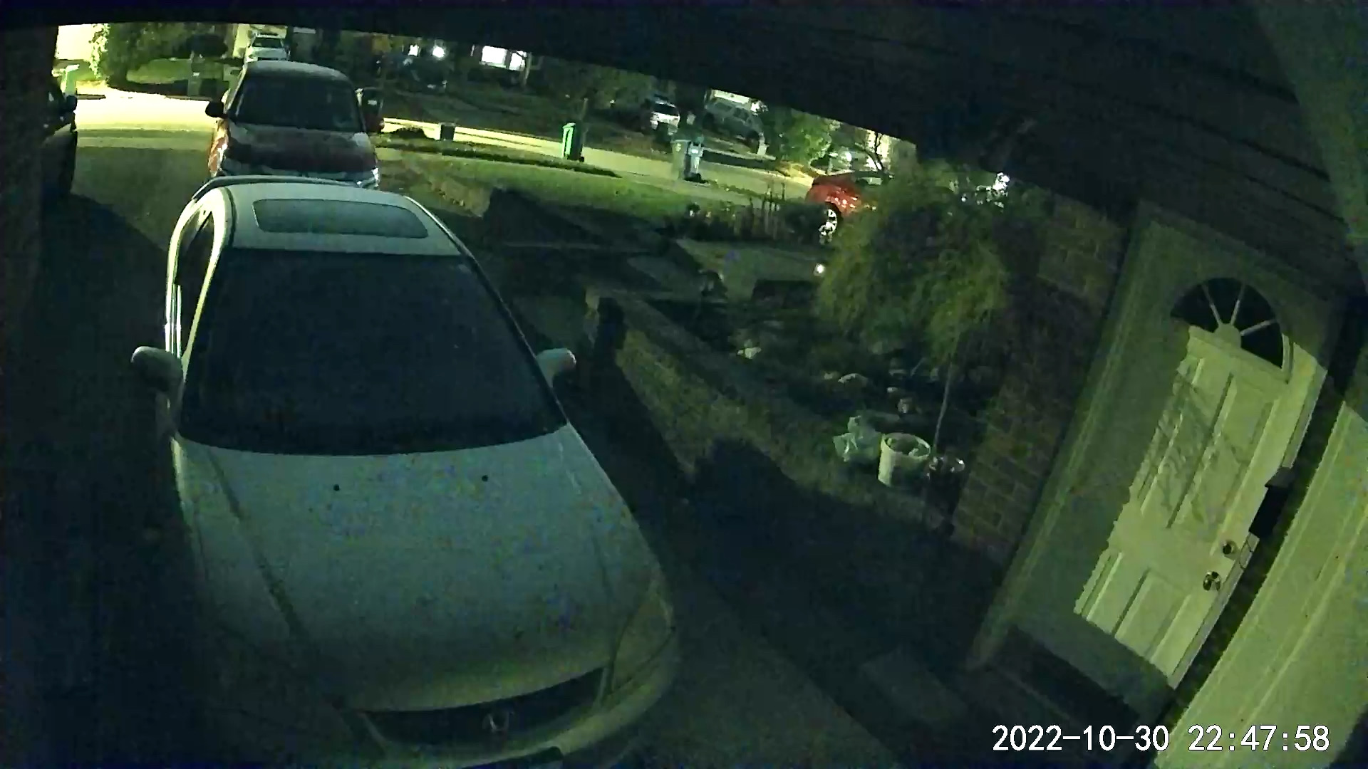

Here is with no floodlight:
