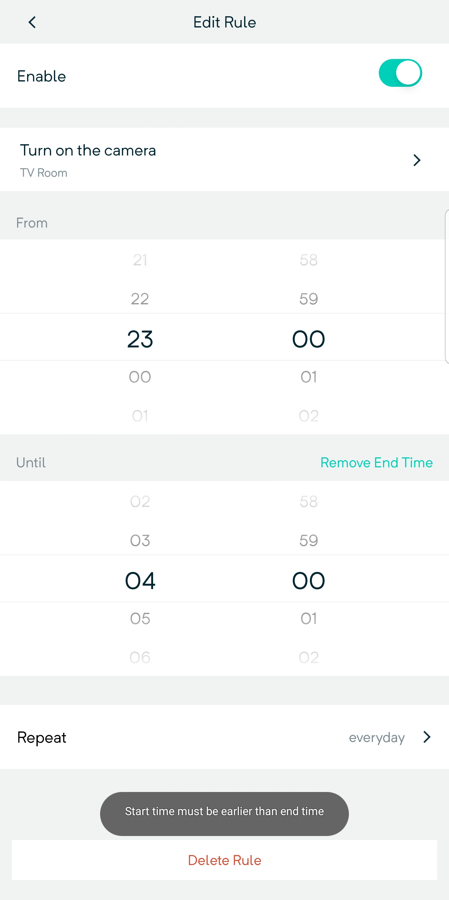

I thought this was fixed, but trying to schedule from 9pm to 4am the next day isn’t working again? Wyze Android Beta 2.5.32.

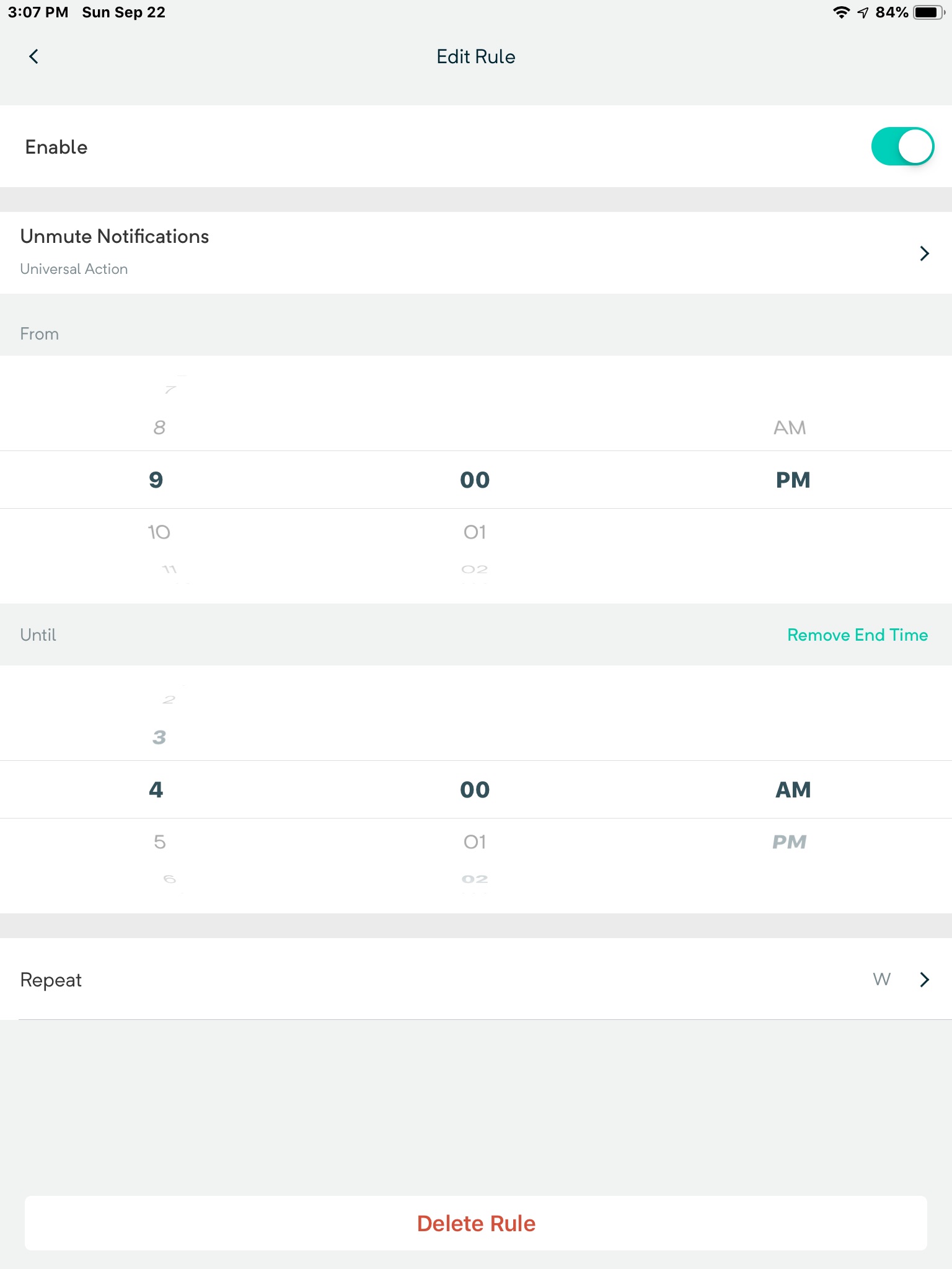

I did - I created that rule as a test and went back to edit just to get the screenshot.
So are you on the new iOS Beta?
I just tried it on the latest iOS 13 beta, and the latest Wyze Testflight beta. It works fine. I’m also not using 24hr time. I set up the rule exactly as OP did.

Okay, so I tried it on my partners phone. Their phone is typically on 24hr time, so I tested that first. That didn’t work, so I swapped it to 12hr, and that still didn’t work.
To clarify this is also on the android Wyze beta.
Okay, so the current Android Beta either isn’t fixed yet, or they reintroduced the bad code. Thanks for the test! ![]()

I’m on the android Beta version and had this exact thing happen last night. My current rule is set for the lights to come on from 8 pm - 5 am (shuts off at end of rule) but since it’s getting darker way earlier I went to adjust it and got greeted with the message that it couldn’t be done. I almost erased the rule (which I would have been so mad about) but decided to test out adding a similar rule. NOPE currently android Beta version will not allow you to make rules that go from any PM hr thru After midnight. This needs to be fixed again.
Hey, folks!
Looks like I need to clarify something here. Right now, schedules that start on one day and end on the next can’t be created. There was a second problem when we made the original Rules change where schedules started and ended late on the same day couldn’t be created and that part was fixed. We have adding overnight schedules on the list of things to address and we apologize for the inconvenience in the meantime. For now, setting two schedules should function as a workaround.
