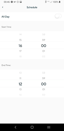

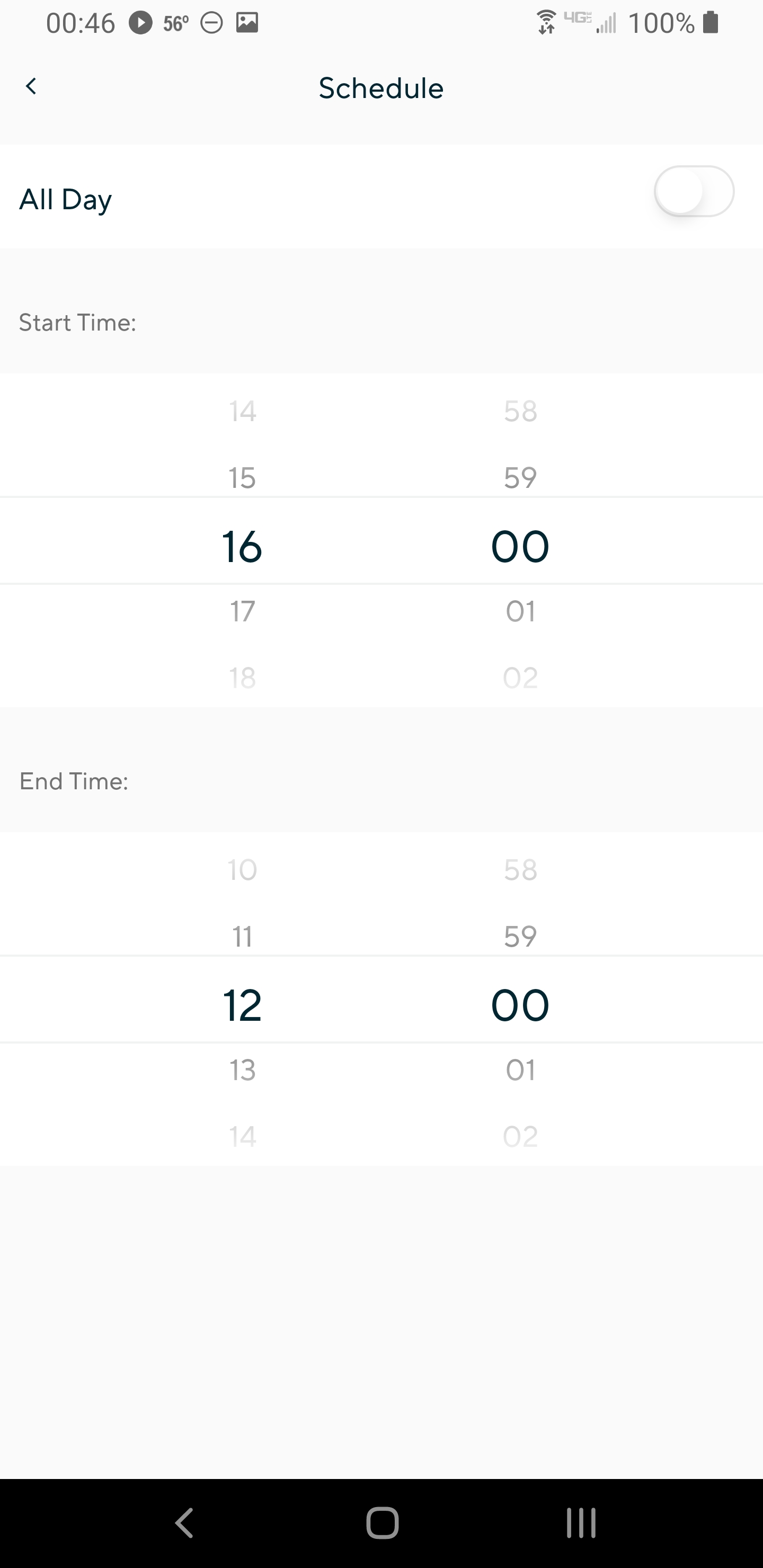

That simple schedule works for me on my v2 cams. For example, this cam is blinded by direct sun from around noon until 4PM. So I record motion events only from 4PM - noon the next day:

Just wondering… before you started applying schedules, did you test your basic cam settings to ensure you even get 24/7 motion events working?
Thanks, Seapup. I have been setting schedules to start 10or 15 mins in the future to see if the new schedule works right after writing it and it often does not. I read in a couple articles that we need to wait 24 hours for the schedule to work and thought that was only if the new schedule had a start time earlier than the time it was written but, as an experiment, I added my new schedule yesterday and tolerated the alerts every 5 mins from 3 different cameras all day but today the schedule seemed to kick in and seems to be working now. Is it normal to expect to wait 24 hours for things to take affect?
I will now start writing schedules and let them sit for a day and see if things work better.
