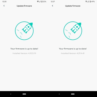

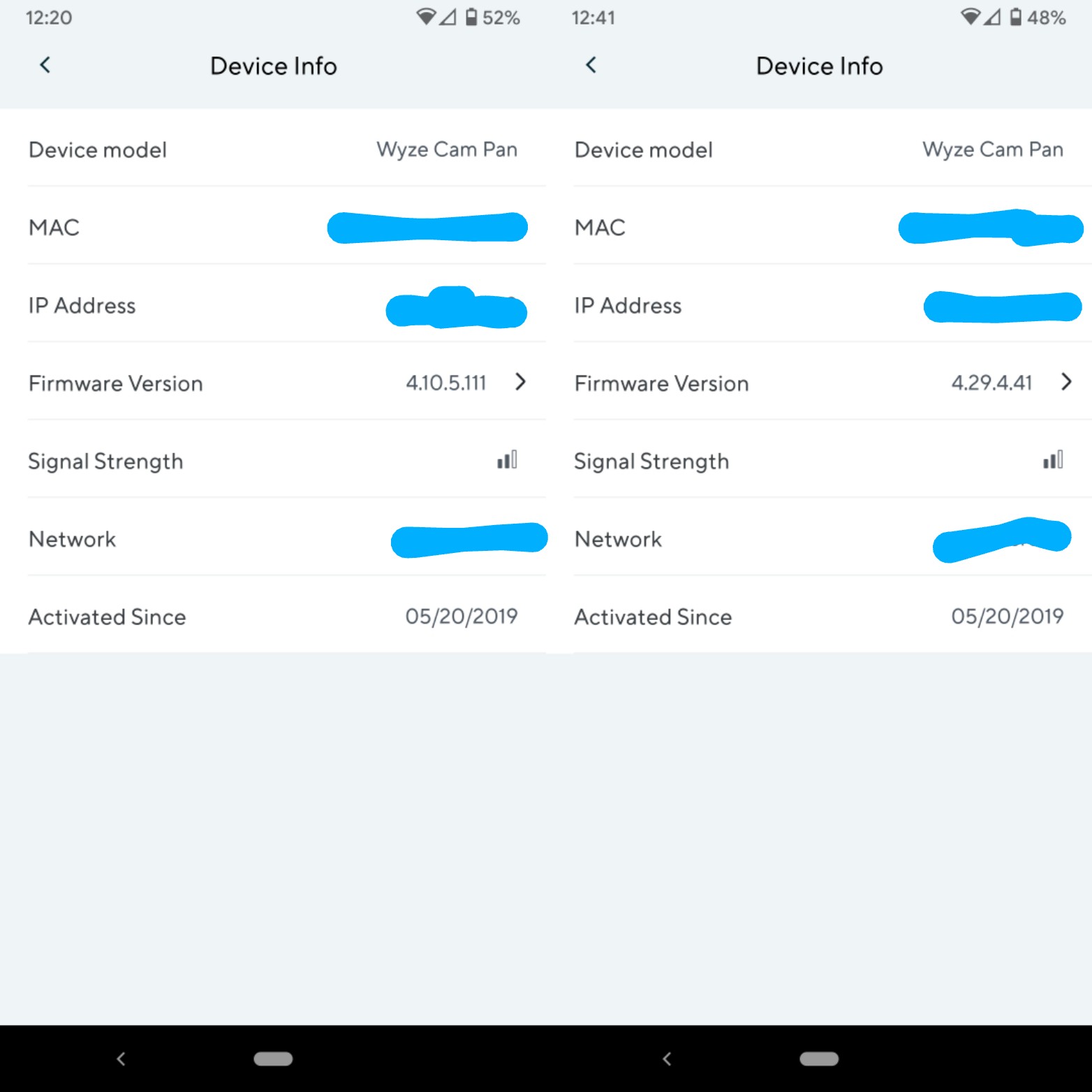

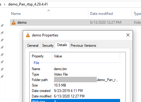

I was able to get it to update. Followed each rule from the RTSP flash page. Some other things I did was use a 32 gig card, formatted it in the camera and did the safe eject in app before I plugged the card into my computer to move the firmware over, and triple checked that I renamed the file correctly. Even though the file extension of .bin isn’t shown, it is labeled that way, confirmed by checking the file properties. When I did the webcam firmware I found out the hard way that demo.bin.bin isn’t demo.bin. :slight_smile:.
Edit/ and i made sure to use 5v 2a power brick

Just wondering…is it possible for you to post the demo.bin file you successfully flashed to your PanCam?
