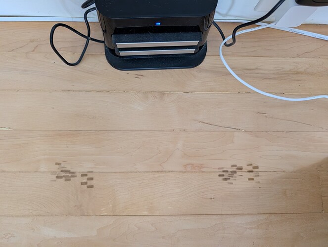

Robot vacuum wheels have permanently stained my hardwood floors

The floor is not abraded in any way. It appears to have burn marks, such as from heat. Again, NO abrasion whatsoever.

I kept checking the wheels but there is nothing on them. And it is not just where it is docked, This is laminate floor.
I also placed ikea PLÖJA desk mat under the charging thing and it went into it also, so it is not that it reacts with any wood finish, it gets into “Polyethylene, EVA plastic”
This has been going on for years, and no one has actually started a lawsuit to my knowledge. Many say they will, but none do. My floors are also all marked up from the wheels, and it sucks, but nothing is going to change about it. Unfortunately, your only real options are use the vacuum, sell it, or throw it away (please don’t throw it away… already too much electronic waste in landfills).
Same here. Fought it for years. Even got a replacement unit and did the same. Very sad that the only way to remove the marks are to have my floors refurbished. If you hear of a lawsuit, I’m in!

Had the vacuum parked and not used for a number of months, just bumped occassionally. 1915 vintage oak floors have the same wheel black color penetration issue into the floor and unable to remove with various solvents.
Yep @RobertD6 , that’s the exact marks I see on my floor that, you would think, can be easily buffed out but no. FWIW, this was an issue with one of the two Wyze vacuums I have. The other has zero issues. Wyze gave me a refund on the one unit with bad wheels, but wouldn’t replace it with one with non marring wheels.

Same thing happened to me. It is not scuffing but a chemical reaction between the wheel compound and the floor finishing. It took a lot of pressure but I got Wyze to cover the repair cost. The marks were in the top cost and not the wood. They scrapped the top coat off down to the stained wood and then applied new layers of the topcoat. Didn’t take long. But like you said, I tried everything and every product to get them off and they wouldn’t come off. I still use the vacuum but have a mat where it docks. However if you do this you are taking a risk because if the vacuum gets stuck and stops for a period of time, it will “burn” those marks into the floor where it stops.
