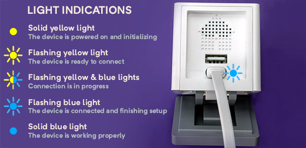

What’s the status light on the camera showing? This will tell what status the camera is in it what it’s doing. Also I like watching the status light as it gets powered on, as that may give clues. https://support.wyzecam.com/hc/en-us/articles/360031137512-LED-Status-Light-Indicator
Based on what this told me, I’d go from there.
