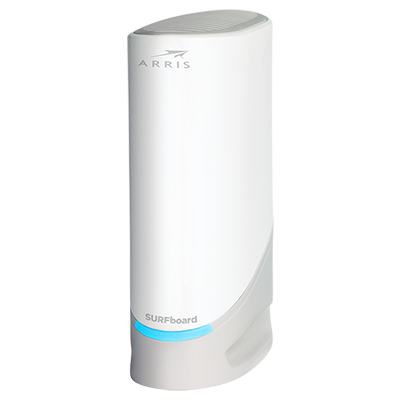

I have Comcast/Xfinity and have a Arris S33 that works well.
You should be fine with any DOCSIS 3.1 that says it is compatible with Xfinity.

The Arris looks like a good option too, as I can just plug my ASUS into it. But since the Netgear already arrived I’ll go with it for now. Thank you!

I was able to connect the Arris S33 modem (thanks @StevenA!) in the closet and setup one of my Asus routers in the living room. Thankfully I plugged the right Ethernet cable into the modem, so the living room ethernet port is active. Connected my Pan V3 to the WiFi and so far no issues. Will probably add a V4 as well, but so far looks like I don’t need more nodes for the apartment.
