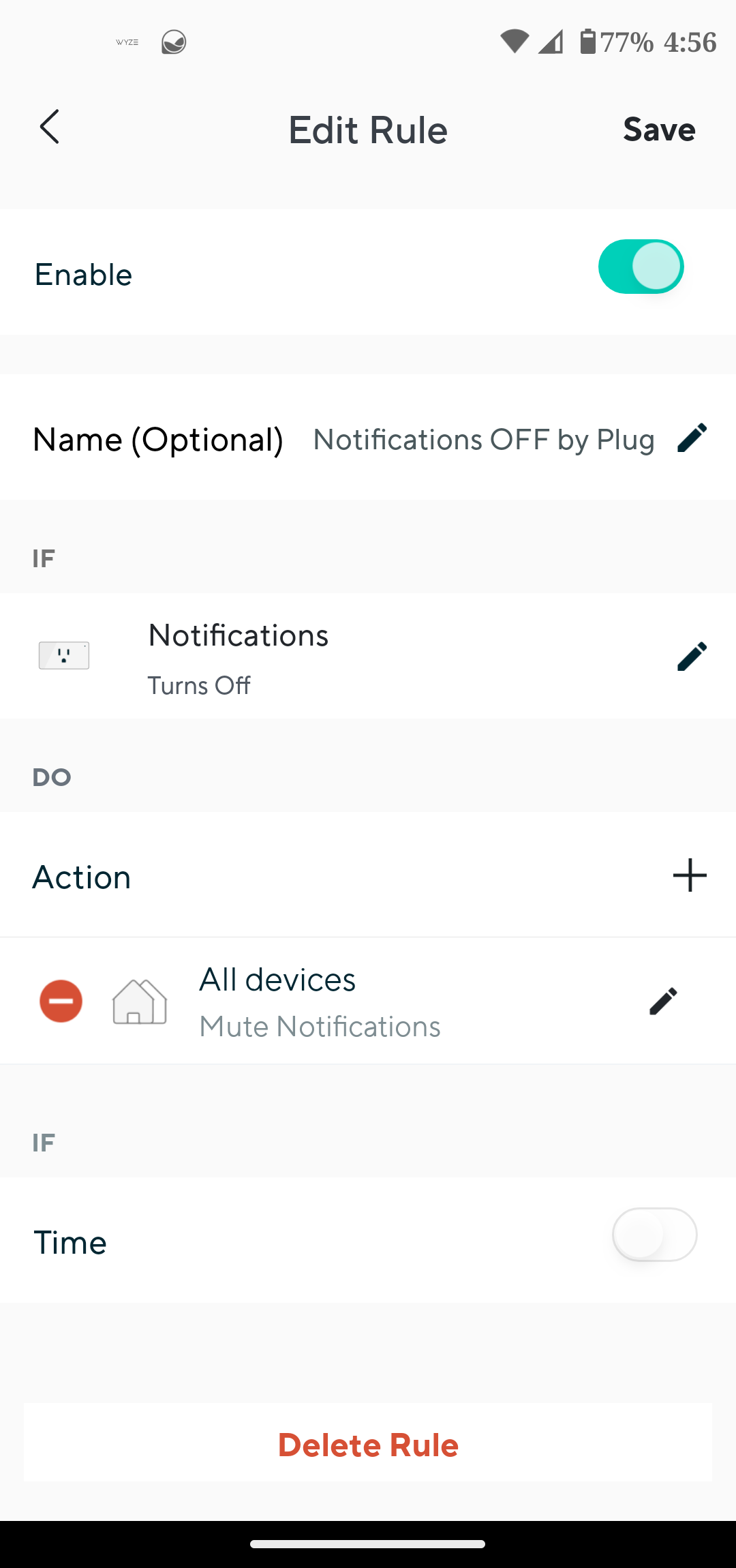

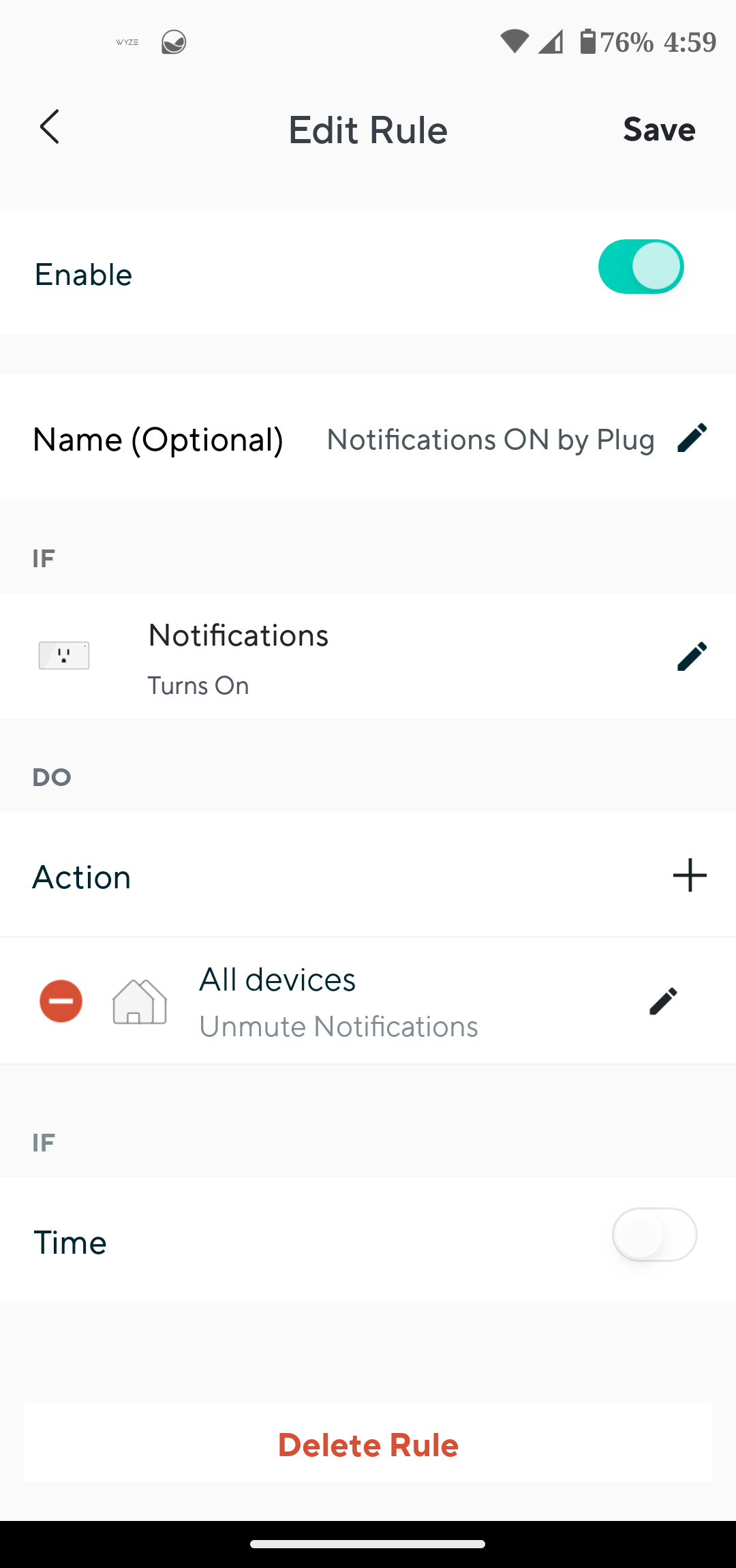

Although the feature is not native to the Wyze App, that doesn’t mean it can’t be done.
I have a Wyze Plug installed that I named “Notifications”. I don’t have anything plugged into this plug. It is just sitting there plugged in waiting to act as a relay messenger to my Wyze app.
I programmed 2 Rules for this plug. When the plug turns off, Mute Notifications. When the plug turns on, Unmute Notifications.
Since I have my Wyze Skill enabled in my Alexa App and I have Dots in the house, all I have to do is to say “Alexa, turn off Notifications for 10 minutes”.
Alexa turns the plug off, gives me voice confirmation, the notifications go on mute, 10 minutes later she turns the Notifications Plug back on and the Push Notifications UnMute.

SlabSlayer - This is a great idea. I’d like to try it. I don’t know much about Alexa. I guess I have my Wyze Skill enabled in Alexa because when I delete and then re-add a camera, Alexa says it added the camera. That’s about all I know about Alexa. And I have an extra Wyze Plug available. I also have Dots in the house. Do I have to do anything in Alexa to make this work, besides adding the Wyze Plug, setting up the 2 Rules. and saying the magic Alexa words?
Since your Wyze Skill is already enabled, when you install the plug, Alexa will also pick that up automatically like she does when you install cams. What you name it in the Wyze app is the important thing because that is the name you will use when you tell Alexa “Turn off [Plug Name] for [X time]”. Nothing else in Alexa needs configured.
After that its just the two rules and speak the magic words.
I took you advise and set this up last night. Waiting for the wind to blow and the cams to go off.
