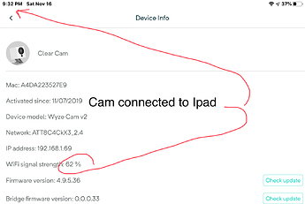

Just for kicks I sat down with Ipad and Iphone on the same network, at the same spot side-by-side, at the same time, and connected to the same cam (one of the ones giving me connectivity issues) as close to simultaneously as I could. I get two different signal strengths for the same cam. I thought the signal strength was supposed to be a measure of strength at the Cam not the device. Shouldn’t they be the same?
Ihave 2 cameras that are both within 3 feet, line of sight, from the main router that covers a 3000sq foot home and none read at 100% signal. I have another camera about 30 feet away from the cheapest repeater you could ever find in 2013, with walls in between, and that one reads 100%. I wouldn’t trust that to be too accurate.
I don’t but I would like to know just what that number is supposed to tell us.
