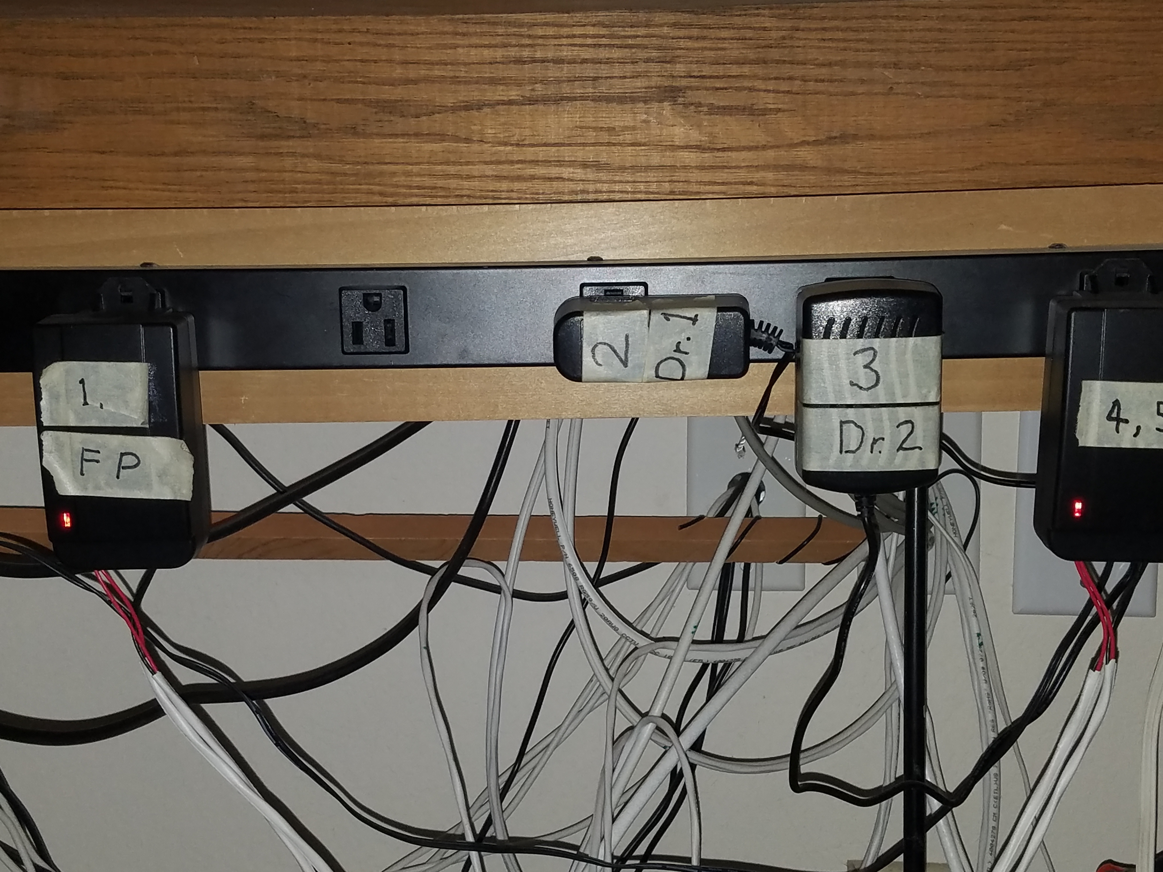

I submitted ‘Powering V2’s with old 12 cctv systems’ to Tips and Tricks a while ago. The article about powering V2 cameras from existing 12V CCTV systems provides some additional construction detail, parts needed and some methods of mounting V2’s. Some WYZE community readers may find it interesting. My existing 12V CCTV system was installed in 2012 and still provides real-time images on the office monitors and on my laptop computer when I am at home. This system is obsolete and lacks the current security protocols needed to send me alerts, hence I installed the WYZE V2’s that would send me alerts.
The V2 cameras are so small and compact that they’re hardly noticed near the old analog cameras. Some of the power adaptors for the analog cameras had to be upgraded to 3A capacity to provide old and new camera functionality.
Being able to use existing wiring to power the V2’s is convenient and there is the added convenience of being able to power cycle a V2 by pulling the controlling power adaptor. All of the power adapters are labeled and near each other under the desk.
Attached are some recent pictures. To see the original detail pictures check out ‘Powering V2’s with old 12 cctv systems’.
These monitors represent two different brands of security cameras. Honeywell and Swann.
The above three pictures depict the many power adaptors plugged into several power bars. The tape labels are for old and new cameras, DVRs, old PIR motion sensors, monitors, etc.
