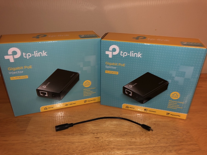

I’ve successfully used PoE to deliver the power to the Wyze Cam but continued to use the wifi. I’m just not a fan of running wires…
How did you integrate PoE with the USB?
I had the PoE Injector and Splitter already. The Splitter has a 5VDC output option. Then, all I needed was a USB adapter - “JacobsParts DC Barrel Jack to Micro-USB B Male Connector Adapter 5V Power Cable 5.5mm/2.1mm” on Amazon.
IMG_7490
Sounds good. I will give that a try. Thanks!
