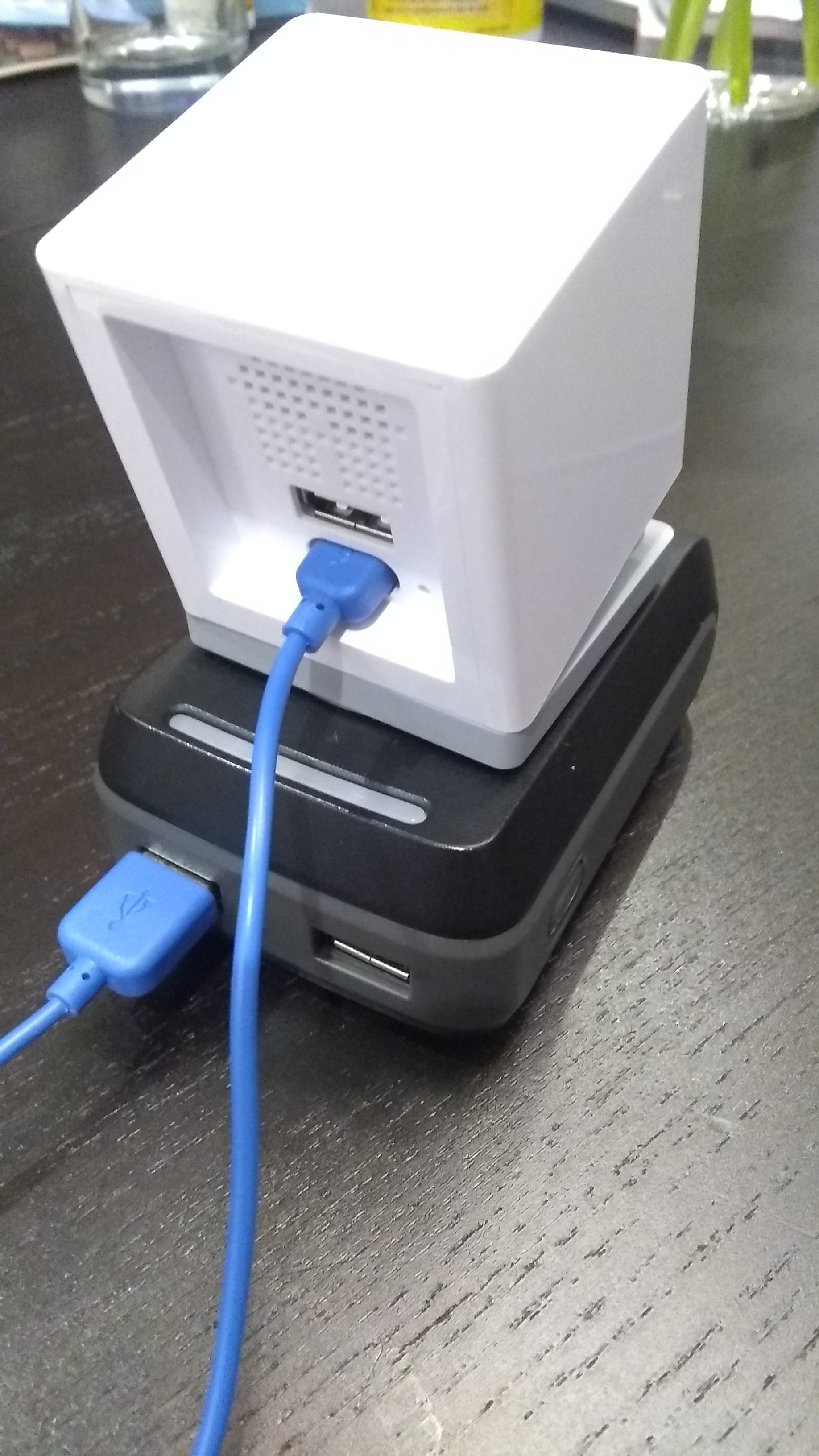

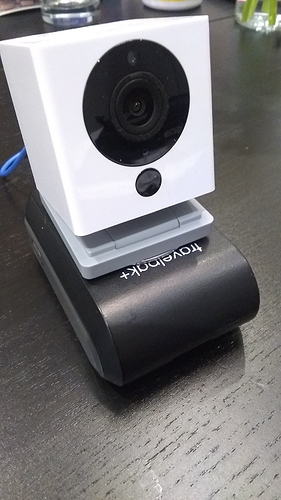

Years ago I bought this New Trent travel charger (model NT700C) and it’s been used pretty much all over the world in our travels. It packs 7000mAH. What I love about it is the built in plug that folds away.
It’s pretty heavy, and it dawned on me that if I stick one of those metal Wyze pads on it, and used a short (6") USB cable, I have a portable Wyze cam. So I did that. I think it lasted around 5-6 hours.
I’m using a Samsung 10000 mAh
in the same way, but it’s a lot less bulk.
Lasts about 23 hours, cost was $16.
Bulky is relative. At 6" x 4" x 0.8" (the Samsung one) I find it bulky, while the New Trend is 3.7" x 2.6" x 1.4" (almost half the area but double thickness).
Just checked out the footage, on the 7000mAH I get roughly 5h15m of footage, and that is at night with the IR one, maybe it would be more during the day.
More juice though, that’s pretty great!
On the New Trend, I can actually plug it into the wall receptacle and the camera stays on the unit due to the strong magnet. That is pretty cool!

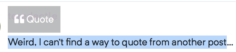

Weird, I can’t find a way to quote from another post… I didn’t see your post @Loki

When you select text from an existing post, you should see a quote button pop up above it like this:
