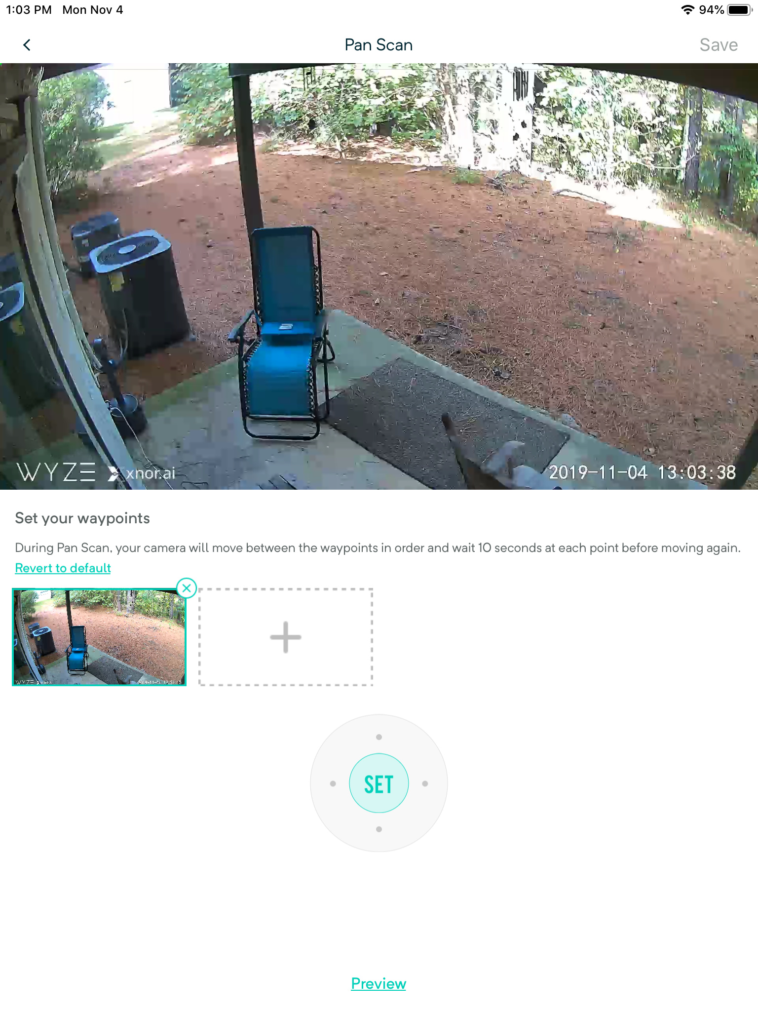

Yes, 2 ways actually. The first is to set 1 and only 1 waypoint. The camera will return to the position the waypoint was set to.
The other way is under Detection settings you can set a Detection Zone. Wherever you defined the detection zone will be your cameras new home position.
Thanks! I had a waypiont set on one cam…but it reset/rebooted and came back on in the home position; not the waypoint.
That’s odd. My settings are below. If I yank the plug out and plug it back in it initially goes to the home position but then hits the waypoint position.
I have now put a way point on the the other two pans. So we’ll see if this helps with things!
