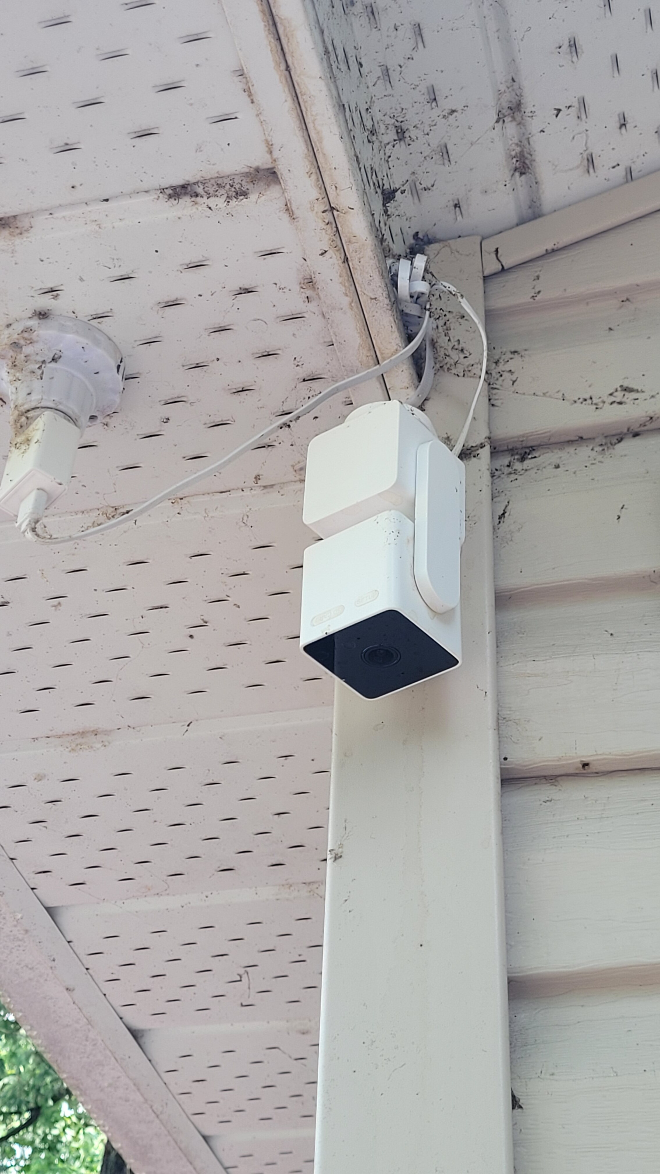

I now realize that I tried the Wyze lamp socket, and gave up in favour of using a standard lamp socket, that I plugged the power adapter in that came with the unit. At present, the unit is offline, pointing straight down error code 90. I have recycled it on / off several times with no joy. Will get the ladder out and do a hard reset yet again. Pic is from yesterday. Pardon the cobwebs. Ron

While up there, I would bring the cam down to bench test it before doing a factory reset and new setup. Place it close to the router and see if it makes a difference and run it for a bit. Test the power adapter to make sure it is providing enough power and test it with a known good one. That power adapter is not outdoor rated, so you may have some issues with it. Even under an eave, they will retain water from humidity and rain.
Hello again. Well I tried a different power supply (5V, 2000 ma). Had to do a hard reset again. Worked 1 day, then quit the next. It does work when I bring it in the house, but that is not where I need it to be. I think you are correct that my problems may simply be it is not for outdoor use. I am going to give up at this point, and buy a product designed for outdoor use, and rated for 5g or 2.4g. I must thank you again for sticking with me to help resolve the problem. Perhaps Wzve will get it together one day.

This indicates it is loosing WiFi signal w\the router when outside. Most likely due to a weak signal or intereference from another device.
The cam is outdoor rated. The power supply is not. Wyze makes an Outdoor Power Adapter specifically for outdoor use.
I have four of these in use outdoors under eaves mounted in much the same way as you. However I am running a 3 node Mesh Network with very strong signal integrity and nodes positioned nearby. I have yet to have one drop offline due to a weak signal.
