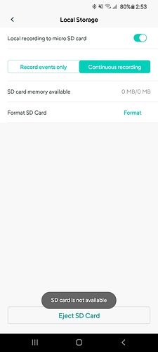

Seems like it, the weird thing is that I have 3 pan cams, 2 I bought a while back and the 3rd one was bought this month and at times it will read the sd card only if you restart the camera, only then it will start recording BUT once the camera uses up the memory in the card it will not rewrite old files, can’t be formatted since the app will freeze and give you the sd card is not available. Once that message pops up you have to forcefully close the app in order to be able to leave app.

  • Tried memory card on the other pan cams and v2 and the card worked.
  • Formatted card on PC no luck, through cam no luck, through SD card formating app and no luck, keeps giving the same problem on the camera.
  • Tried memory cards from working cams and gave me same error
  • Did power cycle and same thing
  • Did factory reset and same thing
  • Removed sd card and tried the cloud service and that did work fine.
